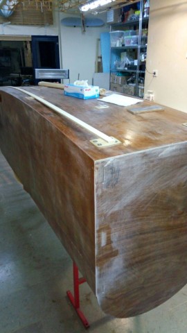

Hi all,
I used T-nuts to attach the control torque rod (pipe) bearings to bottom 1/4" plywood.
I also reinforced the holes with 1/8" 5 layer aircraft ply. I am going
to use Loctite to prevent the bolts from loosening. You can see one of the reinforcements
in the attached photo.
http://forums.matronics.com/viewtopic.php?p=483092#483092
http://forums.matronics.com//files/img_3969_small_194.jpg
