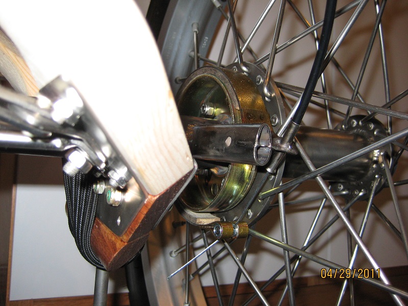

      Hello Crew...been a LONG time!
      Pictures of an alternative below. These are simple go-kart type drum/band brakes
      with my custom made hubs. Perhaps lighter than discs and calipers, but not as
      much stopping power. I used them not for stopping but more for roll control;
      say in and around fuel pits that may run slightly down hill.
      I have 1000,s of pictures and some videos if you need more intel.
      Mike Perez
