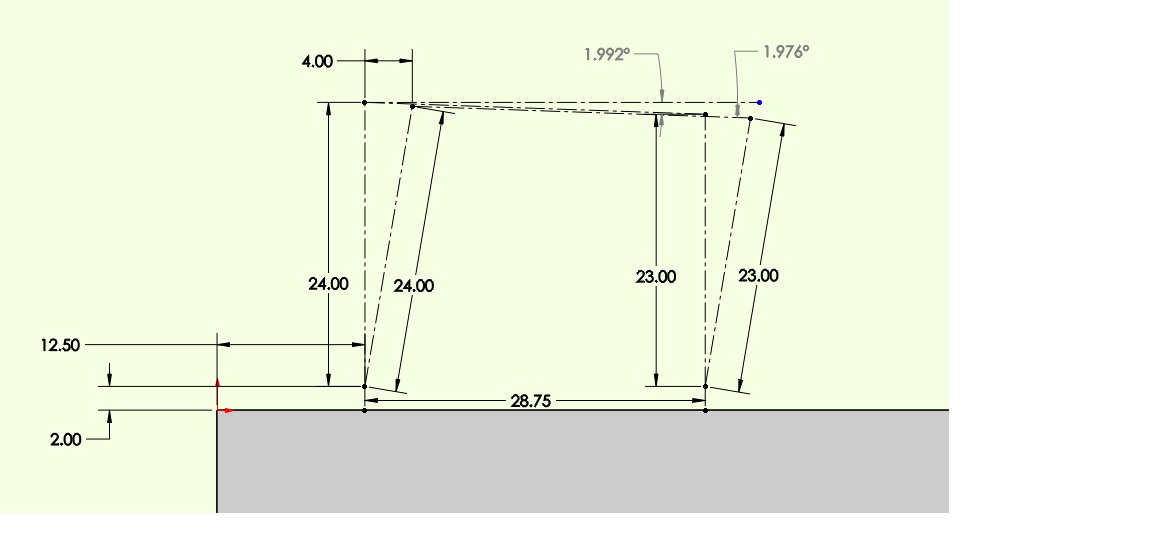

    Gentlemen, I have reviewed the prints very carefully, and here's what I've found... First, my plans are actual BLUE PRINTS, NOT black or blue lines on white background. My plans are dated thusly: Sheets 1 & 2, 1933; Sheets 3 - 7, 1934, and sheet 8 undated. After reviewing my Blue Prints, I believe there could have been a Revision in '34, but never recorded as such. Now then, to the dimensions... On sheet 1, the first slanted truss member is shown to be 28 3/4 in. to the front seat back member. This differs from the F&G dimensions, which calls out 29 in. On sheet 5, the inside dimension between spars is called out at 27 3/4 in. With a nominal 1 in thickness, the C-line dimension between spar attachments to the Cabanes is then 28 3/4 in. Due to both the dimensions on p. 1, and p. 5, being equal, the Cabanes would then be parallel. Note that on p. 1, the fuselage attach fittings are angled to be inline with the C-line of the truss members, while on p. 6, these are shown to be vertical. Per Oscar's post, I've modeled the Cabane dimensions in SolidWorks, and the attached pic shows the difference in the angle of incidence when the Cabanes are moved 4 in. to the tail. Hope this clarifies a few things... As I've mentioned before (and please don't diss me regarding this), these drawings are a complete mess, and should be examined with extreme care prior to building. -------- Tom Kreiner Read this topic online here: http://forums.matronics.com/viewtopic.php?p=488403#488403 Attachments: http://forums.matronics.com//files/cabane_dimensions_447.jpg

    Oscar, All I can tell from that picture is that it looks like you are having fun. Tom, because I'm using a Corvair I should only have to to lean the wing back about 3.5" I got numbers similar to yours, however, when I did the math to determine the change in angle of incidence. Thank guys, Doug Read this topic online here: http://forums.matronics.com/viewtopic.php?p=488441#488441
