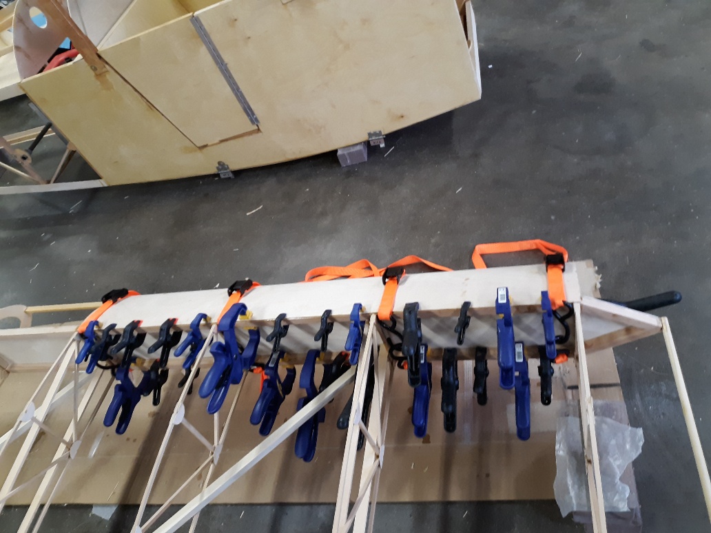

      taildrags wrote:
      > When you boil it all down, the entire airplane is built by just a long series
      of little fiddly stuff!
      Very true taildrags Lots of small fiddly jobs.
      today T-88 was mixed and the piece of leading edge plywood glued in place.
      http://forums.matronics.com/viewtopic.php?p=489890#489890
      http://forums.matronics.com//files/20190627_151242_resized_163.jpg
