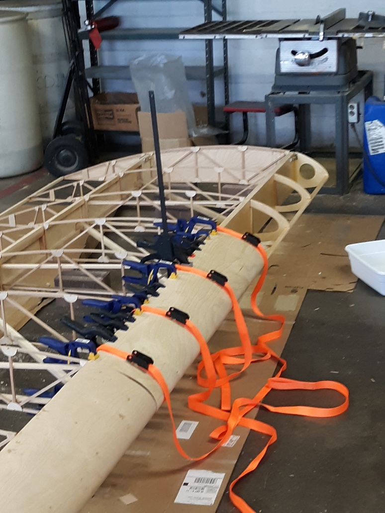

the middle piece of plywood is cut, soaked and clamped onto the leading edge to
form. I messed one piece up by cutting it too short so now have to order another
piece. I did some more varnishing as well
