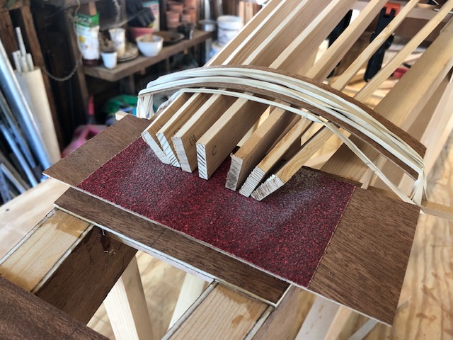

      About your turtle Deck. If you look at the plans Drawing No.2 the upper left, "Side
      view of Rudder and fin". I believe the turtle deck transitions from curved
      at the back of pilot seat to flat at the LE of the horz Stabilizer. If the aft
      end of the turtle deck is curved it makes kind of an awkward place with the
      horz stab being flat. I would never have figured this out had I not had the horz
      stab C-clamped to the fuze when I built the turtle deck.

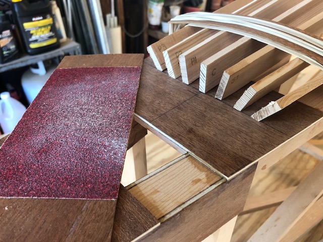

      >Working on building the turtle deck last night and was fretting over how on earth
      I was going to get all those goofy angles at the tail end to come out right.
      Figured itd be about a hundred trial and error trips to the disc sander per
      stringer.
      >Woke up this morning with an AHAH! moment (looking back now it seems more like
      a DUH moment). I just glued a piece of 60 grit sandpaper to the thinnest piece
      of scrap ply I had. Slipped it under the stringers and sanded away. Took all
      of 10 minutes and the angles just found themselves.
      >Dan O
