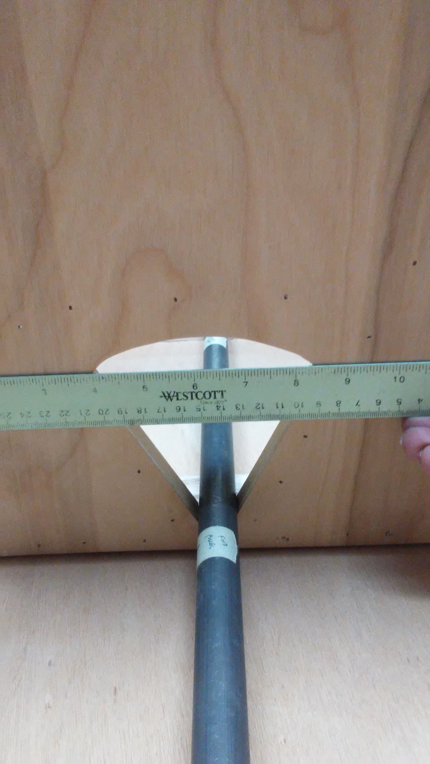

      I'm wondering if the hole I cut out (passenger seat) will be large enough for both
      the torque tube and the connecting rod for both control sticks.

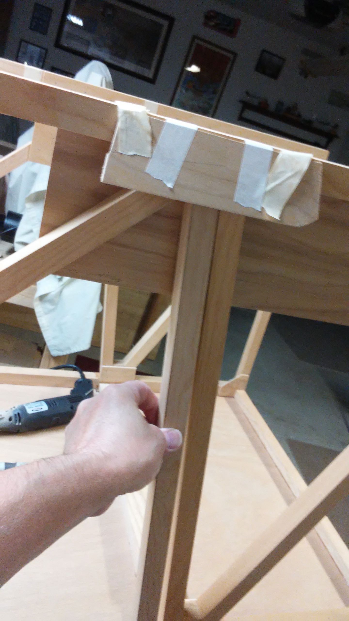

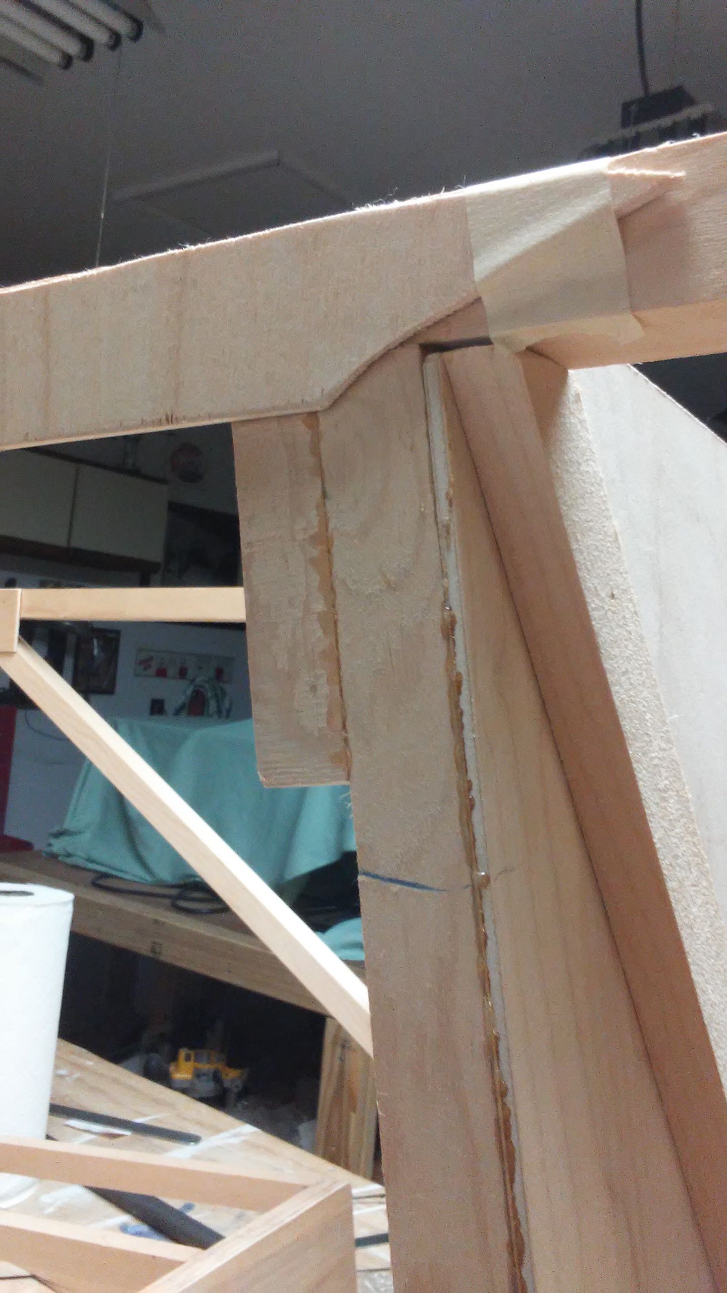

      Also, the plans don't show a block of wood for strut connection at the forward
      area. I'm show a photo of the aft and wondering if my forward is how it should
      look.

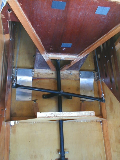

      John; lots of photos of that cutout on Westcoastpiet.com, such as this one of Bob Coolbaugh's build, which shows a much wider cutout than yours: http://westcoastpiet.com/images/Bob%20Coolbaugh/images/IMG_0947.JPG .  Mine is more like yours but it has a 'bite' taken out of one side to clear the linkage rod.  The original builder did this, not me.
