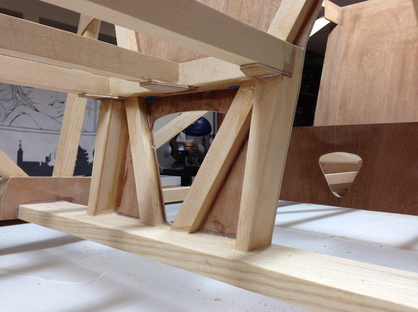

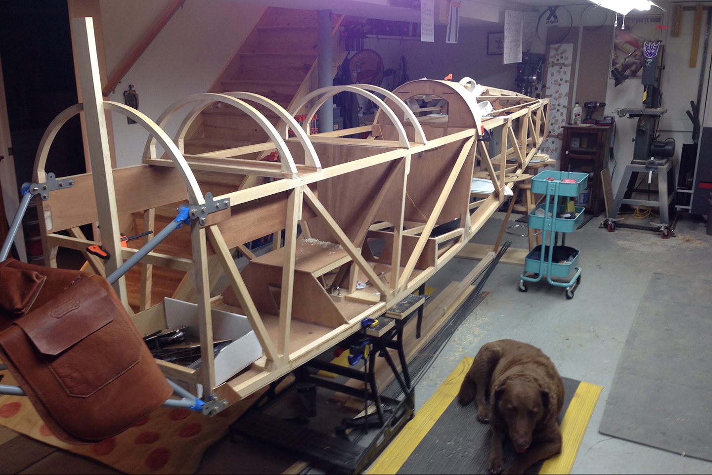

      Hi John
      This is a picture of mine before i cleaned up the glue-
      the hole is about 4.75" wide by 5" high and everything fits fine.
      I did move the connecting rod to the other side of the sticks.
      that way (flying right handed) my hand will hit my thigh before the
      connecting rod will hit the side of the cutout.
      And yes, add a block to the front for the front cabane fittings.

      Earl is that a mail bag on the engine mount?
      Jack Textor

      Haha! yea,  I'm converting the front cockpit to a mail bin!
      it's a leather shop apron

      A beaut!

      Really nice woodwork on the seat framing.  I like the gussets (hidden) on the underside
      of the front seat framing, but the radiused arches forming the top of
      the fuselage are really nice.
