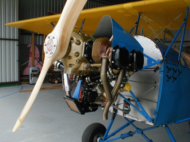

    I'll relate my experience with exhaust stacks on my Cont A65 and A75. The stacks on my A65 were standard Aeronca Champ type mild steel stacks with the aluminized heat muff. They began to show rust spots and pinholes so I sandblasted them and painted them with flat white rattle can VHT exhaust system paint. I had access to a controlled temperature industrial oven so I was able to cure them at the specified temperature for the specified duration. I ran them for another year or two and again started to see rust through the paint so I pulled them and had a talented fabricator use them as the patterns for a stainless steel set. This fellow fabricated custom stainless exhausts for all sorts of engines that were run in engine test cells, everything from big diesels to single-cylinder snowmobile and motorcycle engines. Before I could run the new stacks I swapped out my engine for an A75 and put the new SS stacks on it instead. I had already purchased some Turbo-X from Techline Coatings to spiff them up, but I never bothered... the Turbo-X is still on my shelf and my stacks still look like they did after I got them and ran them up to temperature on a couple of flights. I kind of like the color they've taken on and they sure don't show any sign of corroding. -------- Oscar Zuniga Medford, OR Air Camper NX41CC &quot;Scout&quot; A75 power, 72x36 Culver prop Read this topic online here: http://forums.matronics.com/viewtopic.php?p=493946#493946 Attachments: http://forums.matronics.com//files/a75final002_830.jpg
