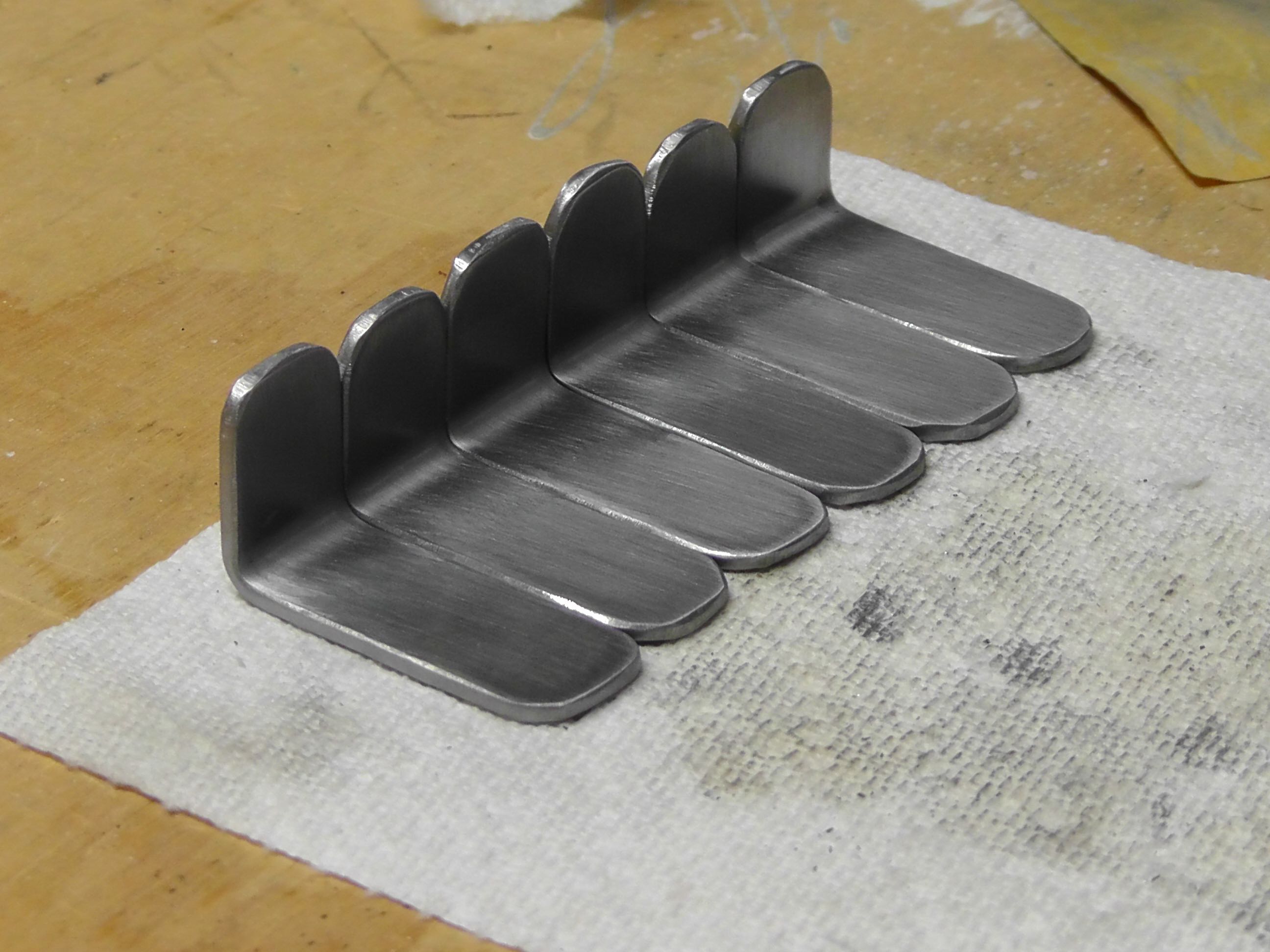

Message 3
| Subject: | Re: Heating after the bend |
A pictures worth a thousand words. I was going to use the rod you see in the second
photo with a vise, but my floor mounted bender seemed to give a rounder radius
(using trial pieces), so went with that.
The bend radius looks OK and no damage noted. I beveled the edges also.
The details in these photos is amazing. I took them from 150 grit to 220 to 320,
and they looked good. Seeing them now, guess I'll hit 'em again.
John C
