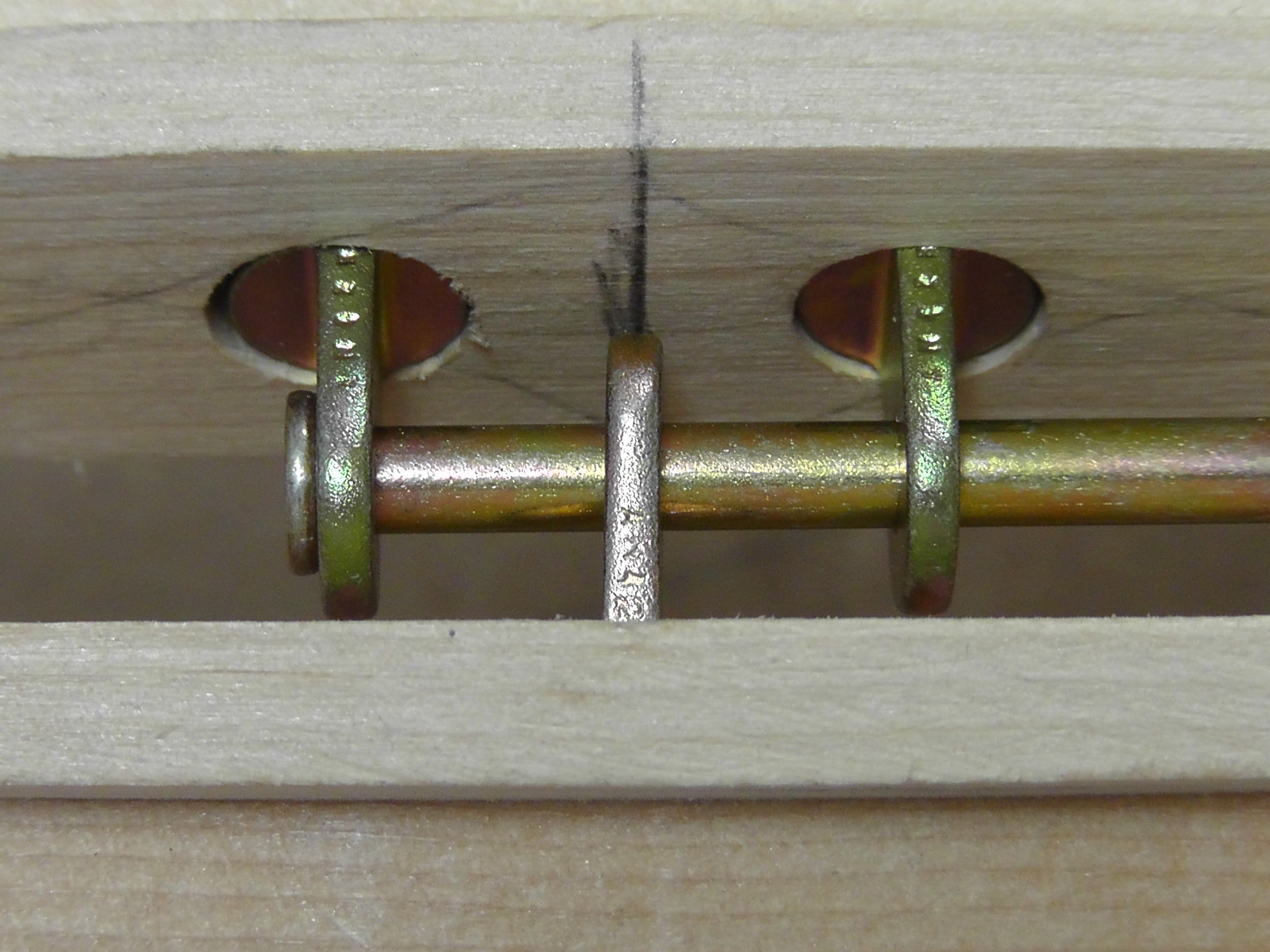

      I'm using eye bolts for hinges. I don't want the holes (3/16") too close together,
      so I spaced them 1" apart (on center). The resulting space on the clevis pin
      adds up to 3/4".
      Should I pile washers in there or is there a spacer I can use...perhaps using some
      tubing.
      Or....should I redo this and space the bolts closer, but then how close is too
      close?

      John; I think I would get some nylon bushing material with the right ID to slip
      over the clevis pin and use two pieces to fill in the gaps.  Self-lubricating,
      tough, light.
