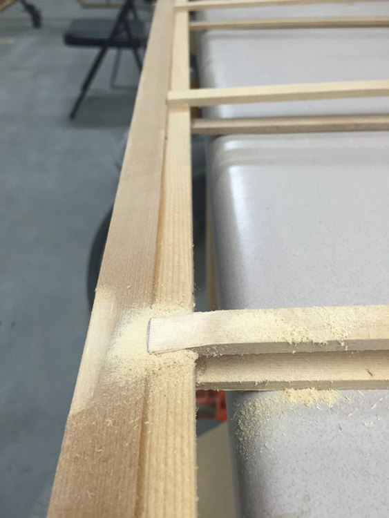

      I would avoid notching the beam there if possible.  While it would probably be
      fine, any notches on the outside surfaces of a beam will weaken it somewhat even
      if there is a piece glued back into the notch.  Picture a floor beam and running
      a pipe through it, you wouldn't want to put a notch at the bottom of the
      beam as it effectively reduces the thickness (strength) of the beam.  There is
      still a lot of the stringer strip left once it is blended in.
      Dan Loegering
      Fargo, ND
      http://forums.matronics.com/viewtopic.php?p=496229#496229
      http://forums.matronics.com//files/img_1162_2_197.jpg

      I sanded them down. They seem plenty strong. I did add a small piece betwee
      n the upper and lower rib just to add some rigidity.=C2-
      Chris
