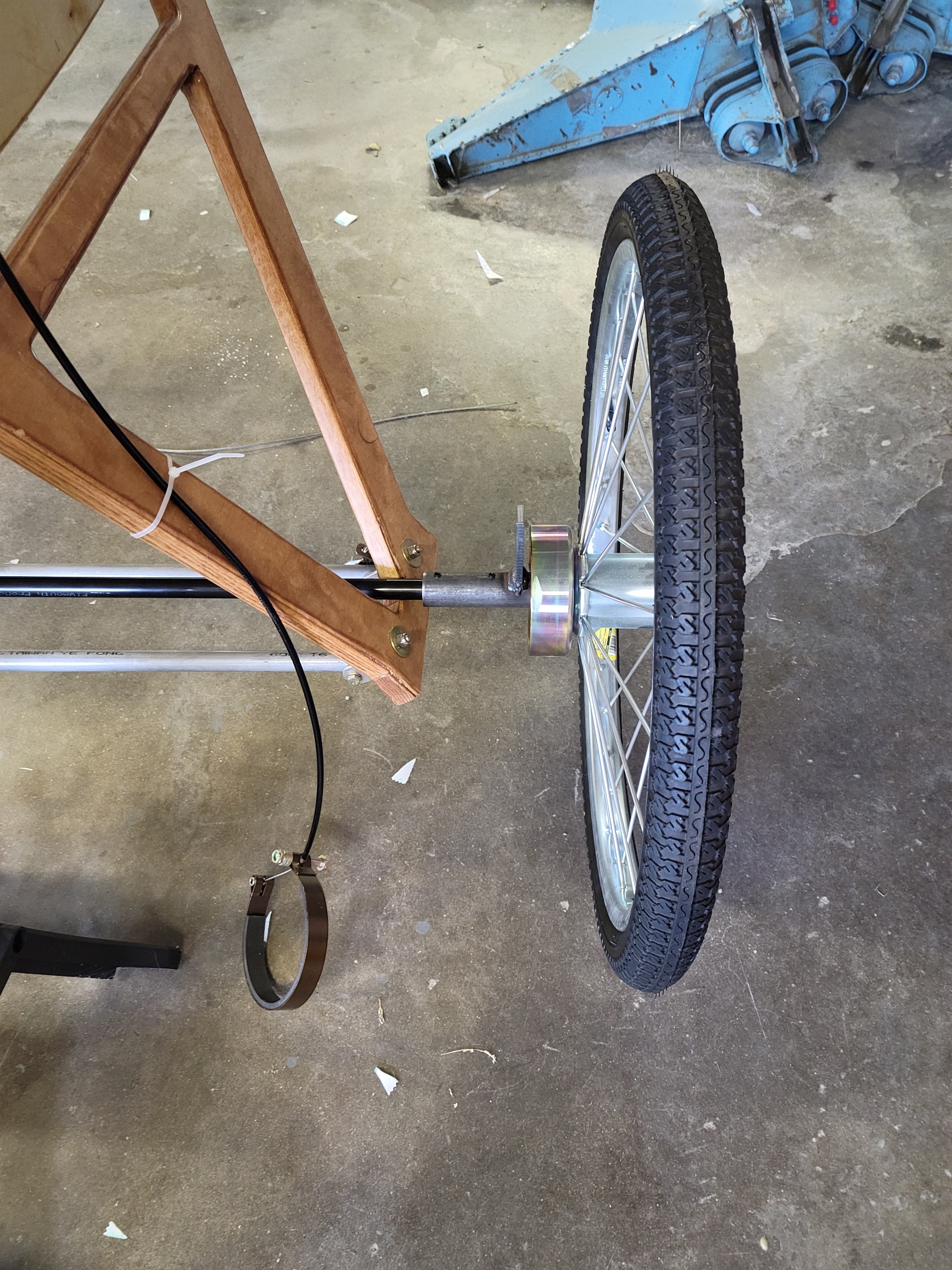

I really am enjoying the covering process. You've probably wondered why the wheels
were off the last few photos. I decided the axle was a bit too short and that
the brake drums would end up cutting the bungee cords. So I ordered a longer
tube to add a few inches to each side. Not only will this give me more clearance
for the brake drums but probably give a little bit better ground handling.
I also got a few little odds and ends done as well.

Hi Lee
how will you stop the axle from rotating when you apply the brakes?
Semih
