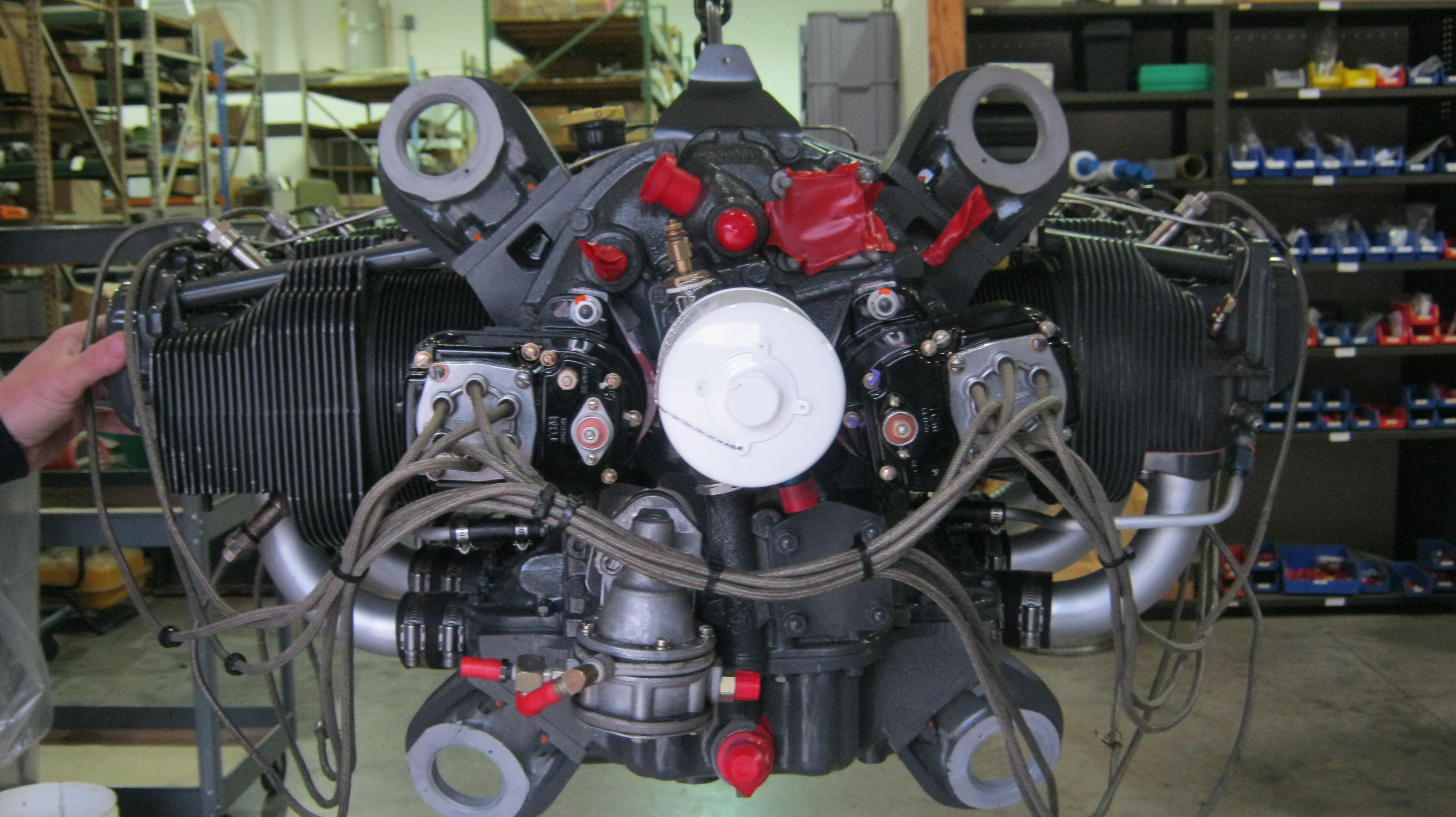

I had my Bendix mags overhauled following a prop strike. The overhauled mags came
back with "ring-and-post" connections to replace the "cigarette" connections
I had previously. (photo attached)
The left magneto has a "retard" post to which I assume my "shower of sparks" output
attaches. Both mags have a pretty evident post to which I plan to attach
the core of the P-lead wire from my magneto switches (I have two magneto switches
instead of a single key-operated starter switch.) I have wired the magneto
switches as recommended by Bob Nuckels in his book, option "B".
The Question: Where does the SHIELD part of the wire get connected to the magneto
to ground it?
The obvious point would be the gold-colored screw to the right and below the left
mag (and the similar screw to the left and below the right mag). Does anyone
have a similar setup with Bendix mags? Please advise.
