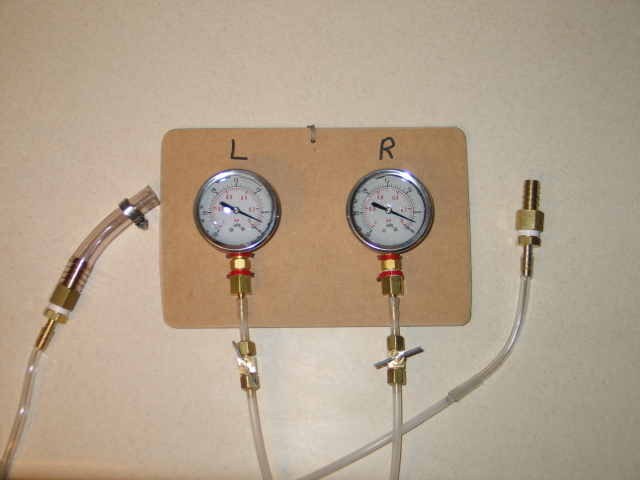

p.s.
you will need aset of vacumm gages. easy and cheap to make.
I think there is a picture here on the forum.
Roger Lee
Tucson, Az.
http://forums.matronics.com/viewtopic.php?p=110992#110992
Message 2
| Subject: | Re: Rotax 912 Idle Speed Setting |
Hi Hugh,
Carb sync tool picture
Roger Lee
Tucson, Az.
http://forums.matronics.com/viewtopic.php?p=110993#110993

I don't particularlly like the tube type because you have to keep them oriented
up and should be verticle and not leaned over. I like the dial type like in the
picture. These can be any orientation and are easy to read. These are just
gages you can pick up at an auto parts or online. The gages depending on how much
you want to spend are $19-$30. Mine are liquid filled. The rest of the gage
parts set is something you can pick up for about $10-$12 at your local hardware
store. You do not need any special vacumm gages to do this carb sync. Something
easy to use and read is the best.
Once you do a carb balance you will find it quite easy from then on. Just remember
that the gage with the highest vacumm is the carb getting the least fuel.
If you need more rpm adjust the carb with the most vacumm which gives it more
fuel and the vacumm will reduce (i.e. vacumm is 12, adjust the carb to get more
fuel and the vacumm goes down let's say to 10). If you need to decrease rpm
then pick the carb with the least vacumm and raise its vacumm number by reducing
the amount of fuel it gets. These adjustments are done by turning the Bowden
cable. That's the main throttle cable that comes into the carb when you use
your throttle. You need to use the idle stop screw and the vacumm gages to make
sure your idle is set at it's correct rpm and the carbs are equal when they
are at idle.
This doesn't tell you how to do it, but maybe a little insite as to what is going
on when you look at the gages or your trying to set the idle when the gages
are connected.
Again if you have any questions call me anytime.
Roger Lee
Tucson, Az.
http://forums.matronics.com/viewtopic.php?p=111052#111052
