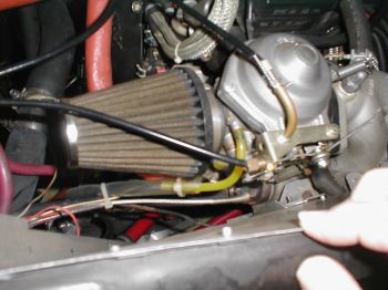

    Subject: Re: 912ULS: Carburettor and Airbox venting lines
    From: "N601RT" <N601RT@comcast.net>
    Tommy, Here is a photo of one vent line going into a larger line in my plane. I drilled a small hole in the top of the larger line near the end of the original length Rotax vent line, just to be sure the vent sensed the local pressure. (Sorry for the delayed response, I've been away for the holidays.) Happy New Year Roy N601RT: 2002 CH601HDS, nose gear, Rotax 912ULS, Arplast PV-50, All electric, IFR, equipped, 895hrs Read this topic online here: http://forums.matronics.com/viewtopic.php?p=155604#155604 Attachments: http://forums.matronics.com//files/912_carb_vent_41_939.jpg
