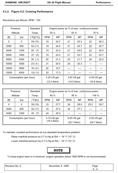

    rampil, I do not know where you got your data but attached is a snapshot of the cover page from my Katana Manual and the page with the performance and fuel consumption table data. See attachments. As you can see there is nothing indicating a variance in fuel flow AT A CONSTANT POWER SETTING regardless of variations in altitude. Per my training, knowledge and experience, fuel flow is a nearly linear function of power being produced, regardless of altitude at which it is being produced. I have never had a fuel flow meter on any of the airplanes I've owned with the 912 series engine but have flown a good bit of cross country time in them at known power settings at widely varying altitudes, and the fuel required to fill the tank after these flights has always been within 1/2 gallon of my projections based on time and power setting during these long continuous power flights at varying altitudes. Also, the EGTs on my 912 read pretty constant at a constant power setting at varying altitudes. Thom Riddle Retired Mechanical Engineer FAA Certificated Powerplant Mechanic http://riddletr.googlepages.com/a%26pmechanix Read this topic online here: http://forums.matronics.com/viewtopic.php?p=163281#163281 Attachments: http://forums.matronics.com//files/da20cruisedata_729.jpg http://forums.matronics.com//files/katanaafmcover_116.jpg

    Hi Tom, Again, the data was for the DV-20-100 912S3 not the DA-20 912. Yes my DA-20 manual looks the same (I have about 150 hours in them) but the manual does not specify what altitude the measurement was made, and since my time was in a rental, I did not bother to try. Re the DA-20 manual, certainly you dont believe the carbs compensated up to the max altitude of 13000? Nobody I spoke every claim claimed they compensated for altitude over 8000, including Eric Tucker who I spoke to at Oshkosh 2005 at some length when he was hanging out at the CPS booth. Unrepentant Electrical Engineer AME Eastern Region -------- Ira N224XS Read this topic online here: http://forums.matronics.com/viewtopic.php?p=163282#163282

    rampil, I appreciate your bringing this increased fuel flow with increased altitude data to us. It was news to me and a bit of a surprise. The good news is that at higher altitudes you get higher TAS with a given power setting, which helps compensate for the increased fuel flow. If my current airplane were certificated experimental I would be tempted to try the adjustable mixture control (HACman) that you mentioned. But then again, most of my current flying is at low altitudes so it might not be an economical solution for me anyway. I'm happy that I can run methanol free 87 octane autogas in our 912UL and burn between 4.0-4.2 gph at 75% power. I still like the 912 series better than any other engine I've flown with. -------- Thom Riddle N221FA Allegro 2000 912UL N197BG FS1/447 -------------------- Believe nothing, no matter where you read it or who has said it, not even if I have said it, unless it agrees with your own reason and your own common sense. - Buddha Read this topic online here: http://forums.matronics.com/viewtopic.php?p=163287#163287
