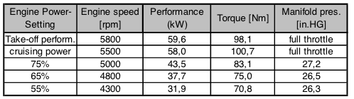

Giles,
You are correct in that there are many combinations of mp/rpm that will produce
equivalent power, which is as you stated, limited by atmospheric conditions in
a normally aspirated engine. That is why Rotax provides tables for the operators
that show the most efficient combination of mp/rpm to achieve standard power
outputs of 55%, 65% and 75% of max.
What is interesting to me is that the combinations Rotax recommends are markedly
different for the 912 and 912S (80 vs 100 hp) engines. See attachments for these
tables. Your statement that higher MP vs rpm combinations are more effecient
is evident most of all in the 80 hp engine table.
Without looking at the Katana manual, I don't recall if the particular mp/rpm combinations
shown in their table are the same as recommended by Rotax. If not,
then perhaps there is room for improvement in fuel flow by conforming to the
Rotax recommended settings.
Thom Riddle

Message 6
| Subject: | Re: Disappointment in Rotax 9 series |
Mark,
That sounds very interesting. Is this system a commercially available set up or
did you put it together? I'd like to learn more about how you did it and how
you estimate the power and fuel flow from the RPM and DMAP.
The more info, the better. I think others might also be interested.
Thom Riddle
