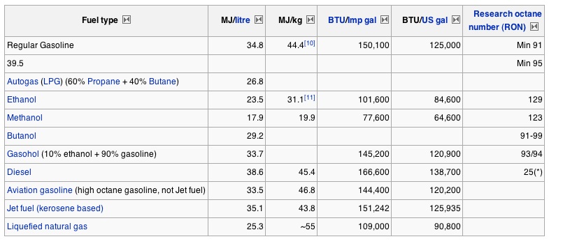

    Henry, Your careful study is very much appreciated. Now you know why Type Certificated Aircraft all have gascolators and they are also required by the ASTM standards for SLSA. Another variable worth noting in the E-10 vs pure gasoline vs 100LL is the energy content and anti-knock qualities. See attached table. Note in particular the following: 1. Not all alcohols are the same 2. E-10 has less energy content than pure gasoline 3. E-10 has slightly more energy content than 100LL -------- Thom Riddle N221FA Allegro 2000 912UL N197BG FS1/447 -------------------- Believe nothing, no matter where you read it or who has said it, not even if I have said it, unless it agrees with your own reason and your own common sense. - Buddha Read this topic online here: http://forums.matronics.com/viewtopic.php?p=182350#182350 Attachments: http://forums.matronics.com//files/fuels_120.jpg
