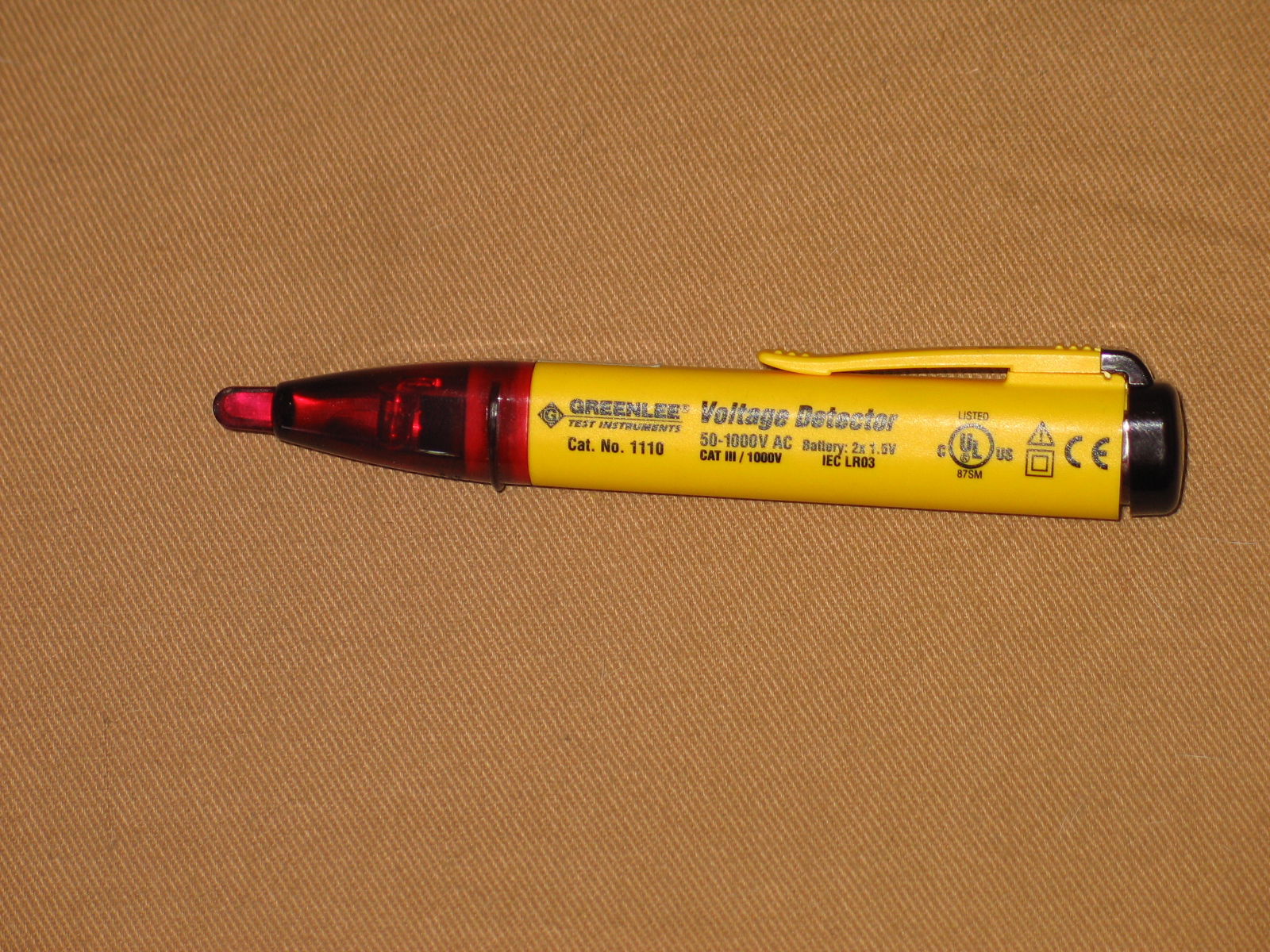

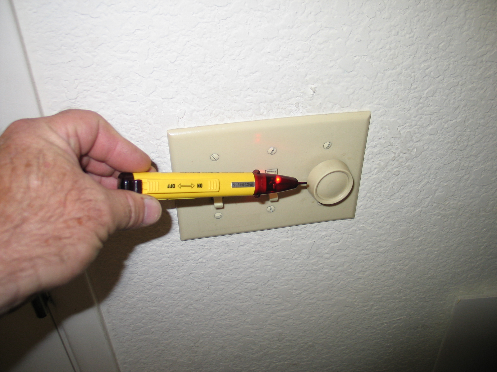

Here is an easy way and a tool to check your plugs and plug wires. Here is a picture
of a AC tester, cost about $12. Spark plugs are AC current. This tester
works by just getting the plastic probe next to the item you want to test. Start
the engine with someone you trust at the controls and chock the tires. Then
while the engine is running hold this tester up by each plug wire and then the
plug. If you are getting a good current flow the light on the tester will light
up steady. If you have a problem wire or plug the light may flash intermittently
or not at all. This way you can trace down the exact place where the problem
is occurring. You can test each plug wire coming out of the ignition modules
and trace it down to the plug. The plug wires coming out of the ignition
coils are screwed in just like they are at the plug cap. I think you will find
your problem in the wires. I had a problem like this 4-5 months ago and the
tester traced it to the #1 plug wire at the plug cap. I unscrewed the wire trimmed
off about a 1/4" and screwed it back in and the problem was gone.
