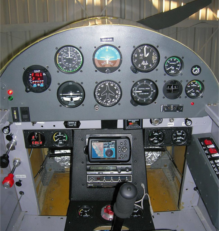

I was planning to mount my Garmin 396 as my primary nav instrument just under the
Dynon D10A. I am in the finishing stage on my RV-4. Trouble is, the thing looks
pretty ugly in the panel using the new snap-in mount that's been developed.
Anyone have a better mounting system, or a recomendation for another GPS that will
do everything the 396 will do, but is made for permanent mounting? (I cant
afford the 530)

Ron,
If you have been following the recent RV-List you can get a
special mount for your unit from Air Gizmos http://www.airgizmos.com for
about $100. I understand Vans sells them as well.
I have one mounted in my -4 to hold a 296. I have uploaded a
photo so you can see. Unfortunately the picture does not show how far it
sinks the unit into the panel but if I had to estimate it is about 60%.
One nice thing about these is that you can remove the GPS if you want to
take home, update or service the unit vs. a custom mount behind the
panel that will make it more difficult to remove.
http://www.make-it.com/RV/Panel.jpg
Robin
RV-4
200 hours
under the Dynon D10A. I am in the finishing stage on my RV-4. Trouble
is, the thing looks pretty ugly in the panel using the new snap-in mount
that will do everything the 396 will do, but is made for permanent
mounting? (I cant afford the 530)
Ron
