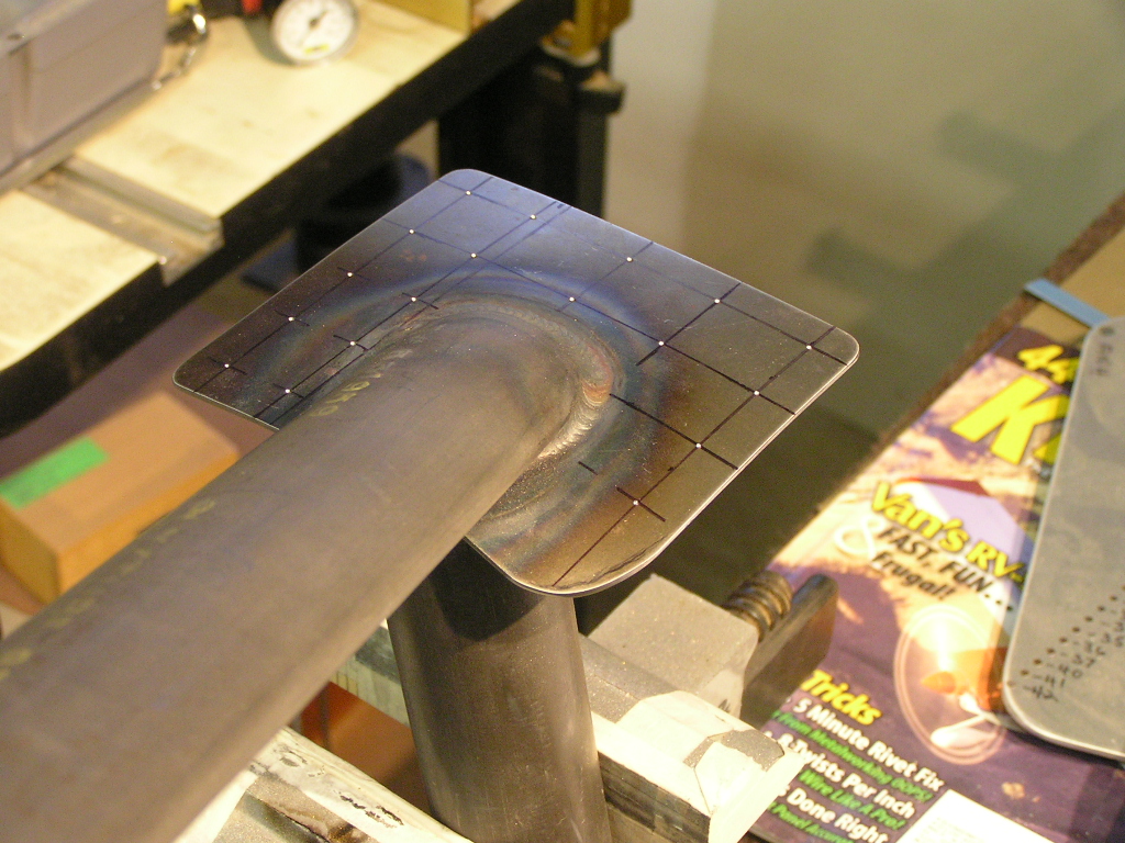

This is not just an isolated problem. My RV-6A steps both cracked. Kit
shipped in about 1995, first flight 1999, cracks occurred at
approximately 500 hours.
Tim Lewis -- HEF (Manassas, VA)
RV-6A N47TD -- 999 hrs
RV-10 #40059 under construction
Chuck Weyant wrote:
> This IS a big problem. Van's says they don't hear anything, therefore
> there isn't a problem as far as they're concerned. I beg to disagree
> with them. I had one step crack in the same identical spot as yours
> Lee (I built a 9A). Called Van's, Scott says, "Hmmm, news to me. We
> haven't heard of any problems with cracks."
> Next day a fellow "nine" driver came over with TWO cracked steps in
> hand off his "nine". Said Van's said the same thing to him. He
> ordered two additional new steps from Van's and sent them pics of the
> steps. A week later a "Six driver" from the other side of the airport
> showed up with a cracked step. All this from one little 'ol airport.
> Not a problem?
> I took it out and delivered it to a big time welding shop here on the
> Central Coast (Santa Maria,CA). I asked if it could be repaired, and
> would he reinforce it somehow? He studied the step and said he
> wouldn't recommend reinforcing it as making it too stiff might
> encourage it to crack again even quicker in a different spot.
> Something to do with the type of steel, thickness, and angles of
> attachment combined with load forces. Stuff I didn't really understand.
> He rewelded it from front to aft underside. I had it repowder coated
> and I reinstalled it. It's been more than a year ago and it's still
> fine. One thing I do do is to use a stool to gain access to the
> cockpit while in the hanger avoiding the steps altogether if possible.
> Chuck
> RV10 Finishing up the Fuselage.
> ----- Original Message -----
> *From:* Ron Lee <mailto:ronlee@pcisys.net>
> *To:* rv-list@matronics.com <mailto:rv-list@matronics.com>
> *Sent:* Wednesday, January 23, 2008 6:33 AM
> *Subject:* RV-List: Step crack
> While preparing for the condition inspection I noticed an unusual
> amount
> of movement in the pilot's side step on my 6A. Checking it out I
> found a
> crack on the inside just under the weld that connects the long
> portion of
> the step to the plate that attaches to the fuselage.
> Yesterday I drilled out the rivets and will remove the step to be
> rewelded
> and somehow have that area reinforced.
> I saw another occurrence of this on the Vans website so people
> installing
> these steps should consider reinforcing that area before installation.
> Ron Lee

Another reason I'm glad I used nutplates on my baggage floor. Looks like
checking this location needs to be part of the annual
_____
From: owner-rv-list-server@matronics.com
[mailto:owner-rv-list-server@matronics.com] On Behalf Of Ron Lee
Sent: Wednesday, January 23, 2008 8:50 PM
Subject: Re: RV-List: Step crack
Here it is. This is on the inside of the step just under the weld.
http://home.pcisys.net/~ronlee/RV6A/StepCrack1Small.jpg

The step might be designed for the standard FAA 170 pound person. And
can't take any extra "G's".
Bruce Bell
RV-4 N23BB
From: Bob Collins
To: rv-list@matronics.com
Sent: Thursday, January 24, 2008 8:03 AM
Subject: RE: RV-List: Step crack
like checking this location needs to be part of the annual

Exactly Bob. When I installed my step as a retrofit I added nutplates
and was glad I did
since you need to access that area to replace the step.
My plan is to have the step rewelded and maybe reinforced. Since many
have had this
same problem, what did you do and what would you suggest that I do in
this situation?
Ron Lee

Message 11
I don=92t know if it will make a difference, but the new ones don=92t
look like
this. On my 7A steps the metal plate extends about a =BC=94 below the
tube
where it goes through it.

Message 12
Here is a shot of my step. 2007 vintage with the lower flange.
http://www.flightinnovations.com/images/fuselage/070826j.jpg
Bret Smith
RV-9A "Canopy"
Blue Ridge, GA
www.FlightInnovations.com
From: Carl Bell
Sent: Thursday, January 24, 2008 10:16 AM
I don't know if it will make a difference, but the new ones don't look
like this. On my 7A steps the metal plate extends about a =BC" below
the tube where it goes through it.

I don't think the problem is inside, its exterior. No need for all the
nutplates and added labor.
To remove the step for repair, all I did was cut a 5 inch square hole in
the baggage floor over the plastic block, bolt and nut of the step unit.
Removed the bolt, made the repair to the step, reinstalled and fastened
a new cover plate over the baggage floor cutout. Easy. And if it
happens again, access will even be quicker with only two or four screws
to remove to gain access.
Chuck

[quote="chuck(at)chuckdirect.com"]I don't think the problem is inside, its exterior.
No need for all the nutplates and added labor.
I can't speak for others but it looks like the crack is along the weld. On my installation,
I increased the hole slightly to accomodate the weld and provide
a more flush fit. So it is visible from inside. Otherwise you'd have to remove
the step for inspection since -- as I understand it -- the troublesome spot would
be covered by the square plate. That's the way I viewed the photo that was
uploaded anyway.
