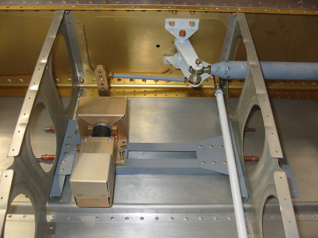

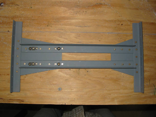

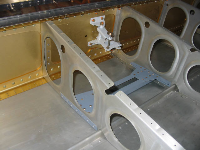

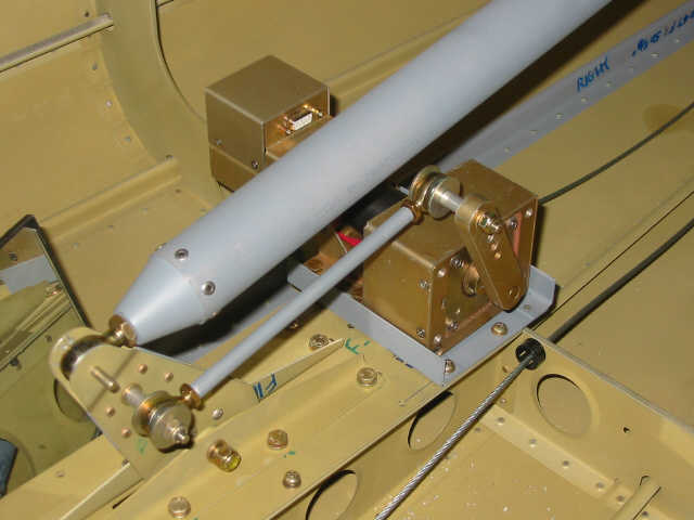

    I had a hard time finding much info on Blue Mountain autopilot servos in an RV-10. So, now that I've got them mounted I figure it's worth posting it on the forum. Hope this helps someone. No words on how well this system works yet... Jim McGrew 40134 - Attaching the wings Attachment: http://www.matronics.com/enclosures/586d03f19e0e5cca120ca0828c3e7e9508e79220.JPG Attachment: http://www.matronics.com/enclosures/42a0f17aca9925470335c2768e2007f6762b7cd2.JPG Attachment: http://www.matronics.com/enclosures/8aa8e472fe431b31d4a8efeb722ca32c77f12f15.JPG Attachment: http://www.matronics.com/enclosures/855dba7dbf421228c0d1c1386a746e31b1bb7c58.JPG

    --> RV10-List message posted by: "Steven DiNieri" <capsteve@adelphia.net> Jim, did bma have any info on the servo install or did you have to cook it up yourself? I'm also going the blue mountain route, Bma sport g4, w/autopilot, so i'm very interested in your findings. Steve dinieri 40205 I had a hard time finding much info on Blue Mountain autopilot servos in an RV-10. So, now that I've got them mounted I figure it's worth posting it on the forum. Hope this helps someone. No words on how well this system works yet... Jim McGrew 40134 - Attaching the wings --
