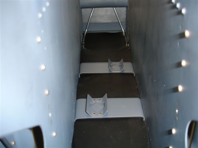

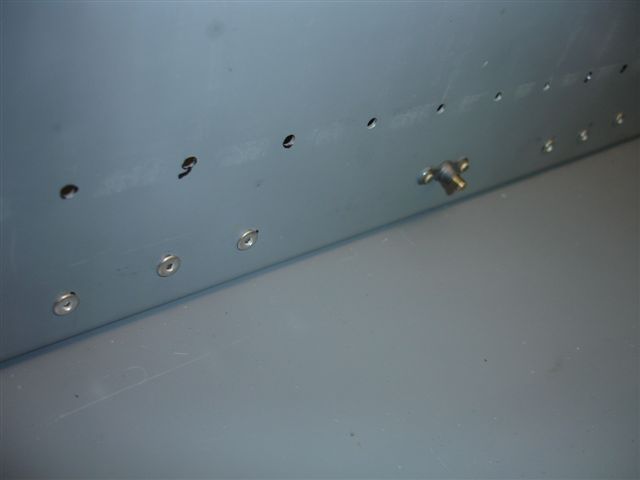

    --> RV10-List message posted by: "zackrv8" <zackrv8@verizon.net> Guys, Here's what I am doing for the HTS (Hot Tunnel Syndrome). I made two brackets that raise up off the bottom floor by 1 inch. They are simple U-brackets made from .050 2024. The existing cradle brackets are then riveted on and three holes on each flange are then riveted to the Tunnel side walls. I have a"KoolMat" insulation layer laying on the floor followed by 1 inch of closed cell foam I bought from Wicks. The fuel lines will be firesleeved when I finish making them. SO much easier working in the Tunnel without the side skins on! Zack -------- RV8 #80125 RV10 # 40512 Read this topic online here: http://forums.matronics.com/viewtopic.php?p=55650#55650 Attachments: http://forums.matronics.com//files/dsc05668_130.jpg http://forums.matronics.com//files/dsc05670_402.jpg http://forums.matronics.com//files/dsc05674_261.jpg http://forums.matronics.com//files/dsc05675_183.jpg
