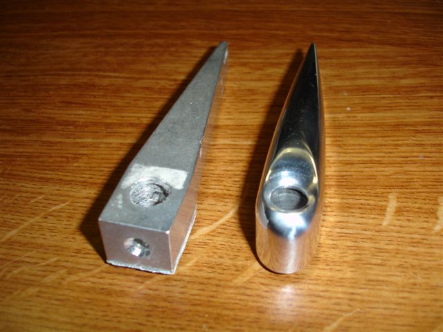

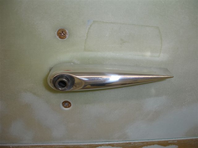

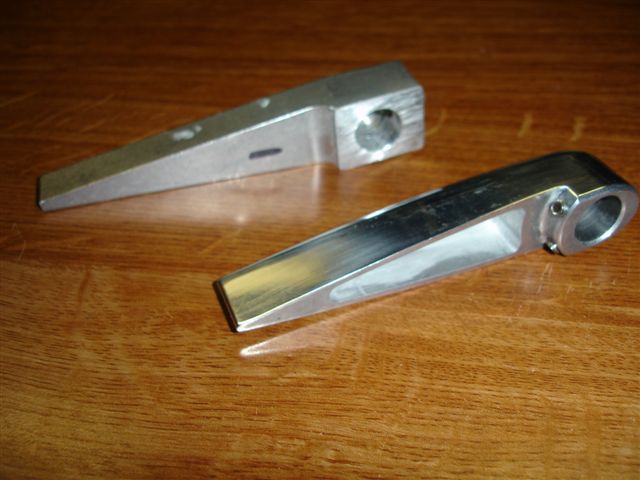

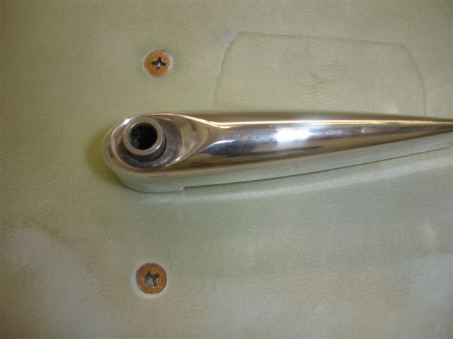

for Vans handle. We slid the new handle on, torqued both set screws, removed
the handle, center punched were the set screws made marks, and put the handle
back on. The center punch makes little divots were the set screws go and
this handle does not rotate. I tried pretty hard...but it doesn't rotate.
Good to go.
Dave is making an aluminum insert that replaces Van's plastic cap. He says it
will be a press fit. Just tap it in. I'll post a pic when I get it.
If you are interested in these handles, you can call Dave at 302-437-6087 or
email him at his new email address.. dczachorowski@comcast.net
Check out the pics below...
Zack
RV8 #80125
RV10 # 40512
http://forums.matronics.com/viewtopic.php?p=79987#79987
http://forums.matronics.com//files/dsc06652_804.jpg
http://forums.matronics.com//files/dsc06648_135.jpg
http://forums.matronics.com//files/dsc06657_111.jpg
http://forums.matronics.com//files/dsc06656_430.jpg
