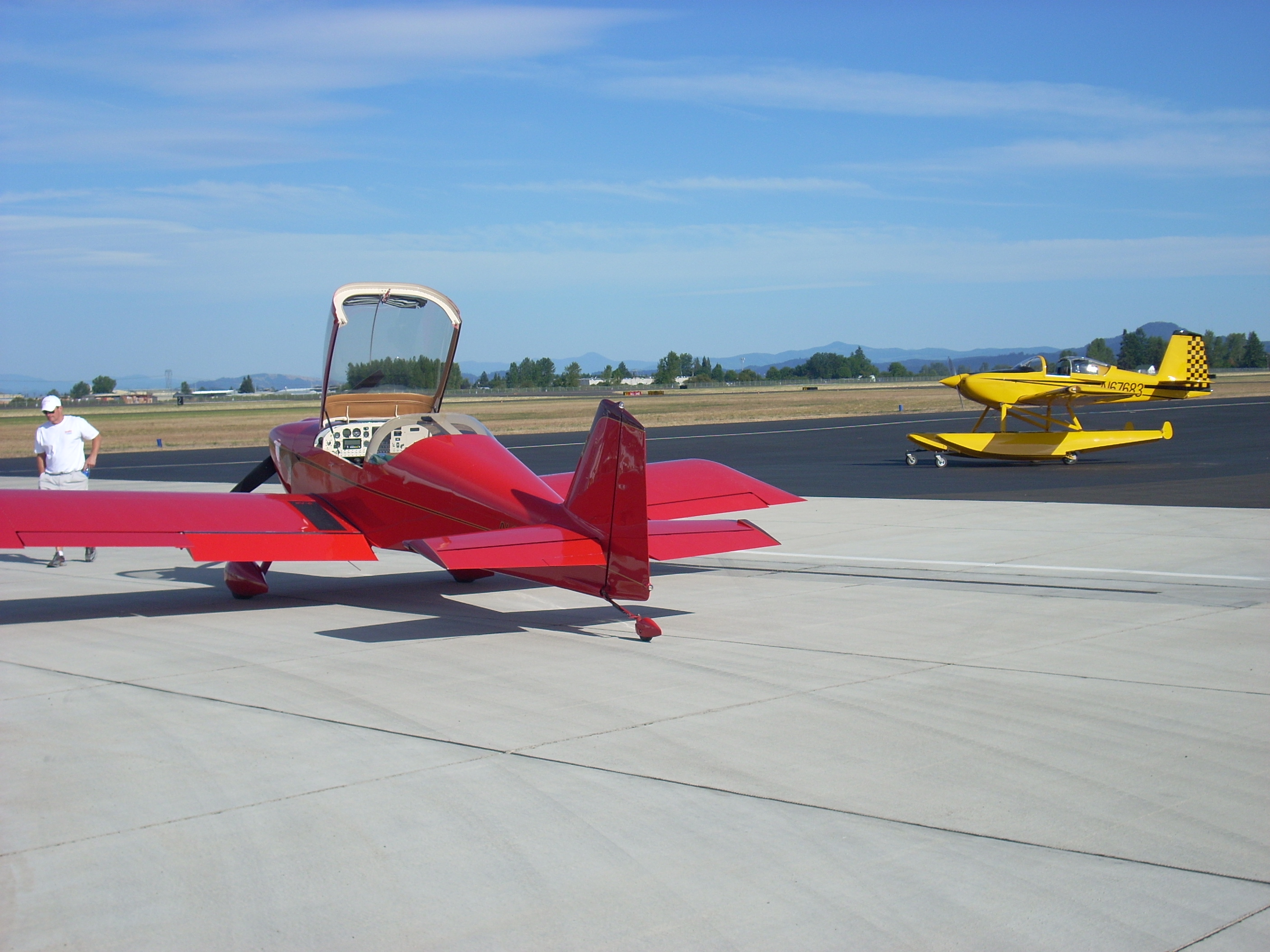

Mary and I met Trey Johnson in Eugene, OR last year while learning how to drill,
dimple, deburr, rivet, proseal, etc from Wally Anderson at Synergy Air. Trey
was finishing his Amphib RV-7 with Wally. Stephen Reynolds who is building an
RV-7 he intends to take around the world, shot the video and apologizes for the
quality. Pretty cool!
http://www.youtube.com/watch?v=KXTGNm5k_-I
David Maib
RV-10 #40559
http://forums.matronics.com/viewtopic.php?p=121139#121139
http://forums.matronics.com//files/dscn0013_148.jpg

Mary and I met Trey Johnson last year while we were learning how to drill, dimple,
deburr, rivet, proseal, etc from Wally Anderson at Synergy Air. Trey was finishing
his RV-7 on amphibs with Wally. Stephen Reynolds, who is building an
RV-7 to take around the world, shot the video and apologizes for the quality,
but this is pretty cool. Who is going to do the first -10 on floats? 8)
David Maib
RV-10 #40559
http://forums.matronics.com/viewtopic.php?p=121141#121141
http://forums.matronics.com//files/dscn0013_108.jpg

Boy, I'd love to do that.
I was looking at the Murphy Moose before I bought the -10 kit, we live on a
lake and would love to park the plane at the dock in the summer.
Biggest problem is the drag . . . we want to go fast!
Jeff Dalton
Wings
