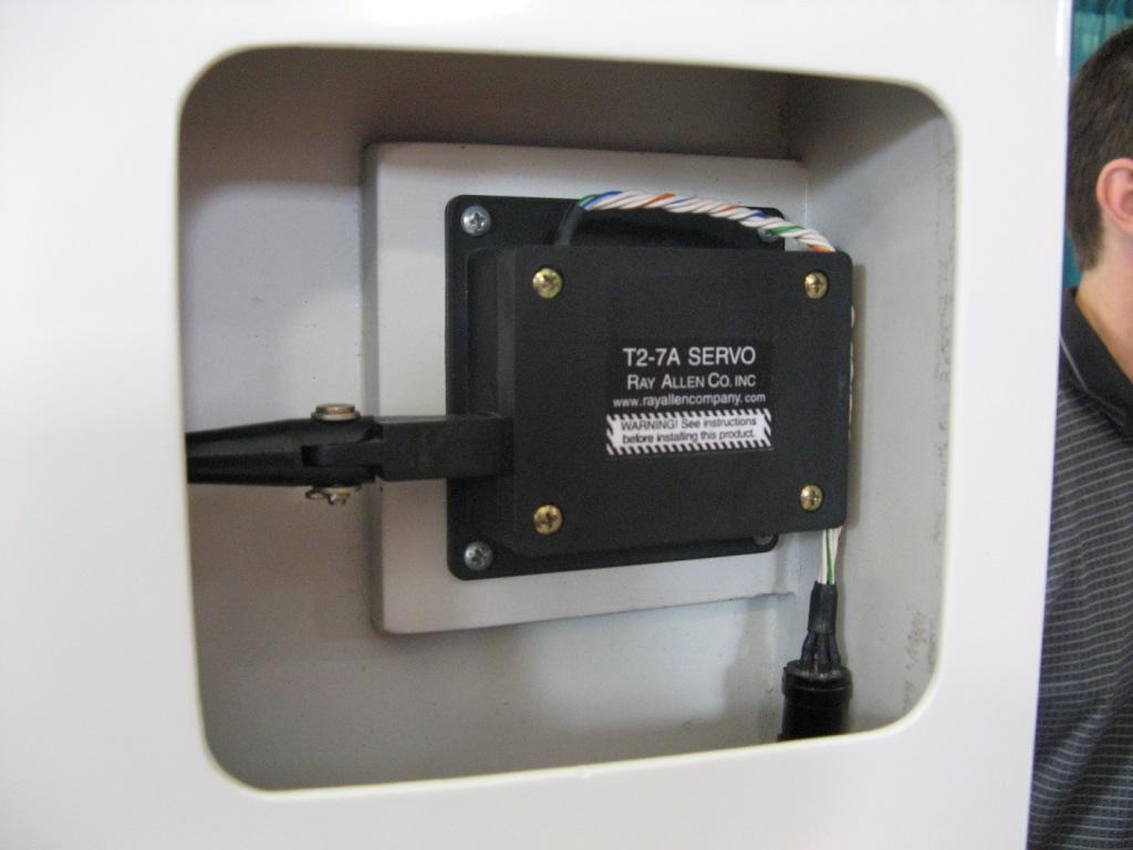

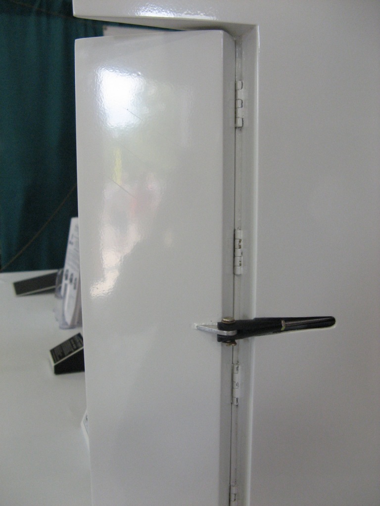

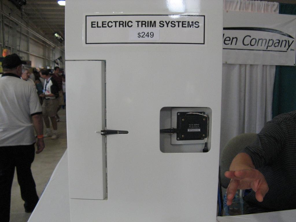

      Hey fellow builders and flyers. My name is Paul Levenda and I'm a new builder in
      AZ. I first of all want to thank all you who have been contributing to this
      forum. I had several months to just browse the forum before building, and my head
      is swimming in all the great information given by those of you who have blazed
      a great trail for us young ones following behind.
      My question has to do with the much talked about rudder trim. I have seen Vic's,
      and I've seen the other comments on the forum, but I have talked with an A&P
      buddy about installing a rudder trim simular to a regular electric trim tab you
      see mostly on twins. I am at a stage where my rudder is still in two halves
      so I want to look at this possiblilty now. I'm thinking I could cut and build
      a trim tab between two sets of stiffeners and then install the Ray Allen servo
      as Vic did. I do not want do any thing drastic until I have my A&P friend come
      look at my plan, but I wanted to see what thoughts the Matronics group might
      have as well.

| Subject:  | Re: Rudder trim input needed |
      Paul,
      I installed one just like Vic did but when I was at Sun-n-Fun this year I saw the
      one Jesse Saint used on one of his planes. I liked it a little better because
      it was smaller and installed lower on the rudder below the elevator. Maybe
      Jesse will post some pictures for you if you ask him.
      I do know if you are going to install one it will be much easier to do it before
      you put the rudder together.
      Dwayne Herring

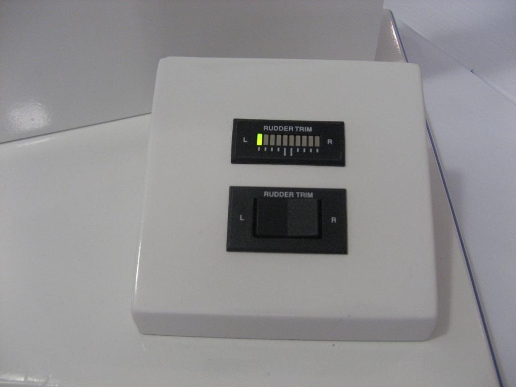

      Paul
      I am also interested, but haven't done anything yet.  I did take the attached pictures
      of the Ray Allen display while at Oshkosh this summer.  Hope they help.
      Bill (and Jon) Reining
      40514
      http://forums.matronics.com/viewtopic.php?p=139849#139849
      http://forums.matronics.com//files/oshkosh_2007_135_117.jpg
      http://forums.matronics.com//files/oshkosh_2007_134_151.jpg
      http://forums.matronics.com//files/oshkosh_2007_133_186.jpg
      http://forums.matronics.com//files/oshkosh_2007_132_416.jpg
Message 30
      Deems and I are working on a rudder trim system that will deploy a flush tab (similar
      to airline speed brake) into the slip stream on each side of the rudder.
      I have a rough sketch not worthy of posting yet but I'm sure we will keep the
      list informed as it develops. One thing for sure, it will be a bunch easier
      to so during assembly than after the fact but we are working on the after the
      fact version. I already have the aircraft and panel wired for it, it's on the
      back burner until I can get the canopy top final riveted. Look for for a good
      drawing and some pics in about two weeks. It will use the Ray Allen servo. It
      works on paper, just need to carefully start the layout and see where and how
      to fit it. The plan is for the control to be tray mounted to allow access to the
      servo and linkage and the actual control surfaces will be mounted using hinges,
      nutplates and screws. The weight should be equivilent to Vic's setup. Of
      course there will be a need to balance the rudder afterwards to make sure there
      isn't a flutter issue with the extra weight built into the control surface.
      Rick S.
