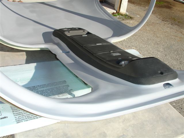

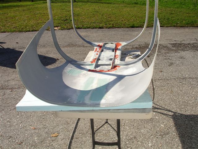

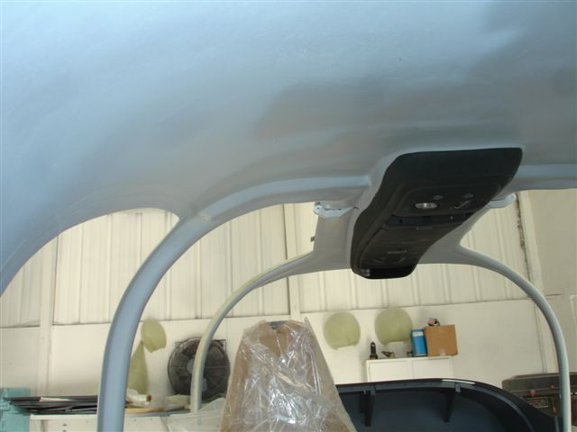

Message 8
| Subject: | overhead console |
Hi Chris,
We are producing a small fiberglass overhead console especially for the 10.
We made the mold from the top of my plane after the strut was in place, so
it fits very nicely around the top of the bar.
I wanted something fairly compact to maintain as much headroom as possible.
It weighs 2.4 ounces and is 1 1/2 inches deep. I attached mine with
flathead sheet metal screws directly into the ceiling.
I have two of Stein's LEDs in mine. I ran the wires up the strut. There's
plenty of room for another dome light and a couple switches, and it's deep
enough to put a 90 degree coax connector inside if you want a GPS antenna on
top.
It also fits nicely on the baggage area ceiling, although I haven't worked
out an attachment method. The honeycomb core wouldn't take a screw too well
so a little beefing up would be in order.
I've been meaning to get these and a few other products on the web site but
your post seemed like a good time to jump in.
Here are a few pictures. I have several in stock. $150 each plus shipping.
Any questions please call.
Dave Saylor

Here's what I did.....
S-10 Overhead Console from Ebay. $50.
Zack
RV8 #80125
RV10 # 40512
http://forums.matronics.com/viewtopic.php?p=162751#162751
http://forums.matronics.com//files/dsc06567_134.jpg
http://forums.matronics.com//files/dsc06555_159.jpg
http://forums.matronics.com//files/dsc06547_203.jpg

Great, now I am one of the guys that said, "here's what I did" from Tim's forum
joke he sent around a few months ago.
But, here is what I did. Did it for less than $20. (not including Steins LED's)
The red lights dim and I hooked the white LED's up to my "Switches" dimmer to I
could dim them as well.
So far, it has worked great. I am going to add two more red LED's from Stein that
point down on my lap. or to the corners of the panel if I wanted.

Zack and/or other S-10 console users, do you know the weight of the console? -Andy

Andy,
I don't know the weight. However, you can "gut" alot of the unneeded stuff out,
thus reducing the weight.
Zack
