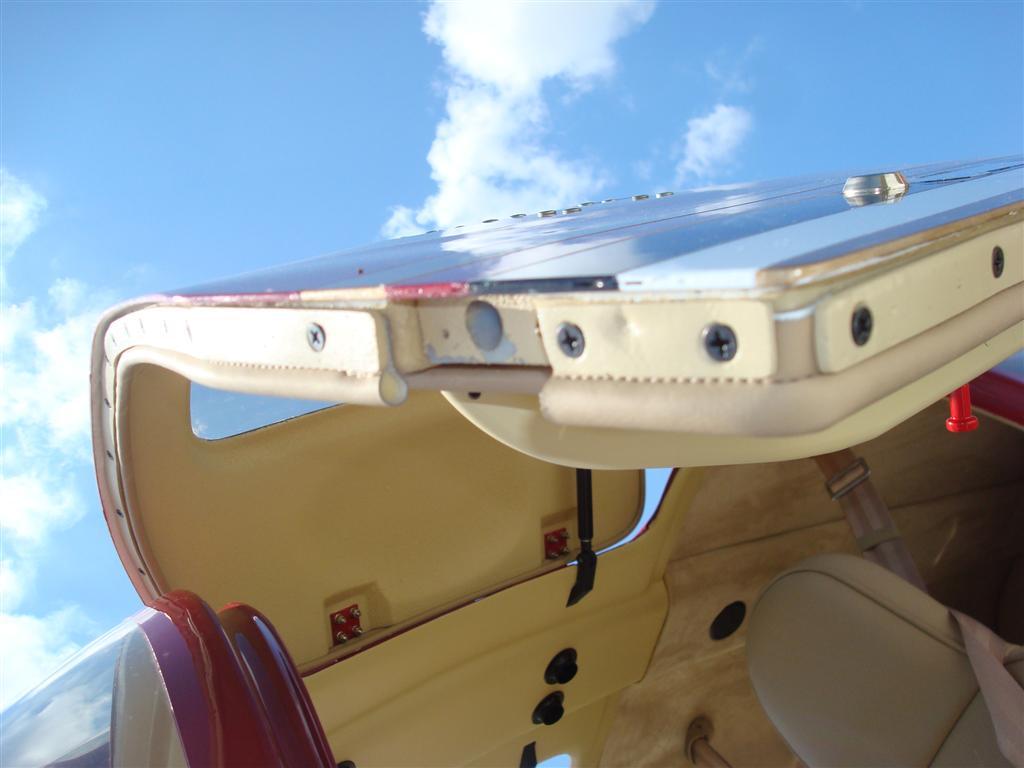

    Here's a picture of Don Orrick's door seal. -------- Regards, Lenny #40803 Fuel System... Read this topic online here: http://forums.matronics.com/viewtopic.php?p 2323#202323 Attachments: http://forums.matronics.com//files/dsc02917_195.jpg

    Lenny That is the one that I saw at KOSH. It was a asterful job - although David mentioned that making the fiberglass trim pieces was quite a bit of work. He had Abby of Flightline *I think* make the seals out of the same material used in the interior. Cheers Les ----- Original Message ----- From: Lenny Iszak <lenard@rapiddecision.com> Subject: RV10-List: Re: Door Seals - Again > <lenard@rapiddecision.com> > Here's a picture of Don Orrick's door seal. > > -------- > Regards, > Lenny > #40803 > Fuel System... > > > > > Read this topic online here: > > http://forums.matronics.com/viewtopic.php?p 2323#202323 > > > > > Attachments: > > http://forums.matronics.com//files/dsc02917_195.jpg > > > > > RV10-List Email Forum - > _- > = - MATRONICS WEB FORUMS - > _- > = - List Contribution Web Site - > _- > = -Matt Dralle, List Admin. > > > >

    I had looked at Don's seals a while back. This is one of the options we are considering since Abby also did our interior. I was just hoping to drive to, and fix the root cause of the problem. In my opinion, since many people experience this same problem, and have provided many different solutions, Vans should provide a 'factory' solution. In talking with Don about his seals, he said the 'bulb' is smaller, and this is what he thinks fixed the problem. If I remember correctly he also said that Van's factory airplane used a seal with a smaller bulb than what is supplied in the kit. Our seals were installed per the plans, although orienting the seal in the opposite direction may help. While placing the seal on the cabin top instead of the door may work, I wonder what the long term durability of the seal will be with people grabbing the door frame to enter and exit. Would it matter if same seal were placed on the door? Thanks, Jason -------- RV-10 Quick Build 4 Partner Build - Finishing Read this topic online here: http://forums.matronics.com/viewtopic.php?p 2350#202350

    I do like the seal on the door, not the frame, just for your reason of grabbing it accidentally. I also like that my seal is very tight and waterproof, but I sure wouldn't argue if it had a slightly smaller bulb as you noted that Don talked about. I think the silicone seals like what come with the kit would seal about as good as you could ever find....but the size is just a tiny bit thick to make the door close easily. Tim Olson - RV-10 N104CD - Flying do not archive jkreidler wrote: > <jason.kreidler@regalbeloit.com> > > I had looked at Don's seals a while back. This is one of the options > we are considering since Abby also did our interior. I was just > hoping to drive to, and fix the root cause of the problem. In my > opinion, since many people experience this same problem, and have > provided many different solutions, Vans should provide a 'factory' > solution. In talking with Don about his seals, he said the 'bulb' is > smaller, and this is what he thinks fixed the problem. If I remember > correctly he also said that Van's factory airplane used a seal with a > smaller bulb than what is supplied in the kit. > > Our seals were installed per the plans, although orienting the seal > in the opposite direction may help. > > While placing the seal on the cabin top instead of the door may work, > I wonder what the long term durability of the seal will be with > people grabbing the door frame to enter and exit. Would it matter if > same seal were placed on the door? > > Thanks, Jason > > -------- RV-10 Quick Build 4 Partner Build - Finishing > > > > > Read this topic online here: > > http://forums.matronics.com/viewtopic.php?p 2350#202350 > > > > > > > > http://www.matronics.com/Navigator?RV10-List > > >
