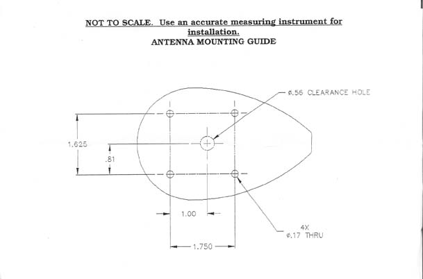

I haven't purchased my IFR GPS yet but would like to fashion a doubler plate
for the antenna. Does anyone have a detailed drawing of the antenna that
comes with the GNS430W unit?
I have the antenna that comes with the Apollo GX-65 GPS/COM. Are the
mounting holes the same? If I use that to drill my holes will the WAAS
antenna bolt up ok?

The GPS antenna I received with my 430W was a GA35.
I have attached a copy of the installation sheet that came with the antenna. Hope
this helps.
