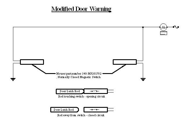

Gary,
This is the electrical circuit using the normally closed switches.
Greg...

When I first received the Door light warning kit and looked over the schematic,
I thought "why so complicated?"
Vans is usually very conservative and will default to the KISS principle unless
there is a good reason to do otherwise. There is a very good reason for the
relays and the seemingly more complicated circuit in the original setup. With
the Van's circuit, all parts of the circuit MUST be functioning perfectly in
order to extinguish the light. The door unlatched or a failure of ANY component
in the circuit will keep the light illuminated as long as there is power.
If a wire breaks, the light will remain on; if the relay fails, the light will
remain on; if any of the switches fail, the light will remain on. The Van's
circuit requires power to the relays to keep the light extinguished.
Changing the switches to normally closed defeats the original purpose of the Van's
design and introduces a failure mode where a break in the switch circuit will
give the indication that all is well when in fact it may not.
I will not be using the relays but I will be using the normally open switches.
The AFS EFIS has inputs for things such as this and wired to normally open, can
trigger a master alarm whenever the input line is NOT grounded. This configuration
adheres to the Van's principle. If there is a break or failure of any
component in the circuit, the light (master alarm) will remain illuminated.
William

Message 14
| Subject: | Re: Door warning switch |
Good observation/explanation.
Kevin
40494
Subject: re: RV10-List: Re: Door warning switch
> schematic, I thought "why so complicated?"
> unless there is a good reason to do otherwise. There is a very good
> reason for the relays and the seemingly more complicated circuit in the
> original setup. With the Van's circuit, all parts of the circuit MUST be
> functioning perfectly in order to extinguish the light. The door
> unlatched or a failure of ANY component in the circuit will keep the light
> illuminated as long as there is power. If a wire breaks, the light will
> remain on; if the relay fails, the light will remain on; if any of the
> switches fail, the light will remain on. The Van's circuit requires power
> the Van's design and introduces a failure mode where a break in the switch
> circuit will give the indication that all is well when in fact it may not.
> switches. The AFS EFIS has inputs for things such as this and wired to
> normally open, can trigger a master alarm whenever the input line is NOT
> grounded. This configuration adheres to the Van's principle. If there is
> a break or failure of any component in the circuit, the light (master
> William
> http://nerv10.com/wcurtis/
Message 15
Interesting explanation. This is why I uploaded the diagram and idea. I needed
some thoughts into this change before I wired it in. Thanks for the replies.
Greg...
