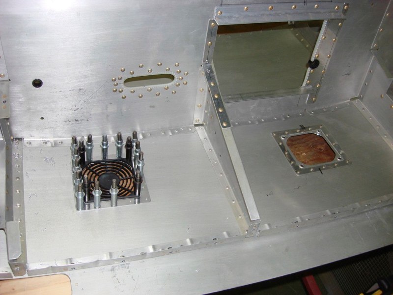

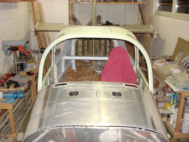

Here is what I did. you'll find more on my new webpage under panel-work.
Cheers
Michael

Message 2
| Subject: | Re: Defrost fans |
Hey all,
Given my recent experiences with the door magnets and affects on the
compass/magnetometer, just a gentle reminder to consider the magnetic
fields typically generated by DC motors when setting out your panel.
Cheers,
Ron

Wish I knew what a bad idea it was before I tried it. I got one hole
thru ok. The cutter grabbed and gave me (thankfully) a small rip in
the cowling. I ended up cutting a pair of doublers for both fans.... I
found out just how lucky I was with the cowling as I tried to cut the
doublers. All is well now but not a fun weekend.
Bill "riveting the front panel cowling this week" Watson
I used a fan as a drill guide and drilled the four mounting holes. Then I
traced a circle pattern with a sharpie, drilled a pilot hole or four inside
the pattern, used the cheapy harbor freight body saw to rough cut up to the
line then cleaned up to the rest of the way with the dremel tool and/or
jewelers file. It went pretty quick and looks great sitting in the garage
buried in fiberglass dust.
-Ben Westfall
#40579

Message 13
Agreed. Should not be any different than leading edge HID landing light
openings with the exception of greater curvature.
Robin
I
inside
the
garage
-Ben Westfall
#40579

Great pics! I just want to add that I did the same cut for the HID per
Tim, using the same HF tool. That was the hairiest procedure I've done
on the plane to date... and that was 2+ years ago. WooHoo! I mean that
curve seemed to me to be the minimum possible with that saw and that
blade. It's a crude, noisy, vibrating, non-featherable tool. So the
greater curvature for the fan is a good thing.
In retrospect I should have done the same for the fans. But if you are
doing the cut for the HIDs, eat your Wheaties first. I'm still a bit
shaken by how close to disaster the whole process was. But it turned
out well. I'd probably use my die grinder and some files now. I've
learned to love files.
Really great pics. I would have used a drum type sander on my die
grinder. I don't use the flat face sander as much as I should. Both
sanders are handy tools.

Here are the pics of the work in progress. I didn't seem to take any
pictures of the finished product. For those that plan to use the body saw
and are worried about that tight corners use your step drill to open it up
so all you have to do is cut straight lines. I know I did that but damned
if I can find a picture.
I do remember thinking "am I really going to cut into this perfectly formed
leading edge?" I think I backed off with the drill about 3 times before I
could work up the nerve.
Ben Westfall
#40579
