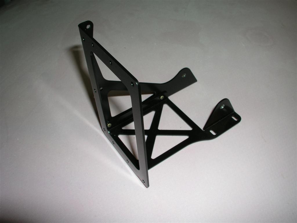

| Subject: | RV-10 trio pitch servo install |
Finally downloaded my pics from the camera. Here's my install. The
plate has the left and right sides bent downward and the aft side is
bent up for stiffness. I used the 4 aft screws of the pivot plate, and
the one under the servo I countersunk. Any questions?
Lenny Iszak wrote:
> Does anyone have install pictures of the pitch servo from Trio Avionics?
> Regards,
> Lenny
> #40803

Message 12
| Subject: | Re: RV-10 trio pitch servo install |
Thanks Linn, looks good, what thickness of aluminum did you use for the plate?
Lenny
http://forums.matronics.com/viewtopic.php?p=242110#242110

Message 14
.060
> Lenny

Message 16
Can anybody post pix of the elevator Trio mounting? I used the provided mo
unting plate but the arm from the servo to the elevator control arm ended u
p being a lot shorter than I would have expected vis-a-vis the materials su
pplied. I'd like to verify that I did it correctly. Thanks=2C Dan
From: pitts_pilot@bellsouth.net
Subject: Re: RV10-List: Re: RV-10 trio pitch servo install
.060
Lenny Iszak wrote:
Thanks Linn=2C looks good=2C what thickness of aluminum did you use for the
plate?
Lenny
Checked by AVG - www.avg.com
Windows Live=99 Hotmail=AE:=85more than just e-mail.
http://windowslive.com/online/hotmail?ocid=TXT_TAGLM_WL_HM_more_042009
Message 17
Dan,
Linn's photo is of the elevator mounting of the Trio servo.
Lenny
Lenny
#40803
http://forums.matronics.com/viewtopic.php?p=242126#242126

Message 20
You are correct! I miss spoke (brain fart). I need to look at where the aer
alon connects to the Trio AP. That's where I'm having trouble. Thanks again
. Dan
> Subject: RV10-List: Re: RV-10 trio pitch servo install
> From: lenard@rapiddecision.com
> Date: Thu=2C 30 Apr 2009 11:43:58 -0700
> To: rv10-list@matronics.com
> Dan=2C

Message 23
I'm not there yet, but they do sell a nice black anodized roll servo bracket.
I wish they would have given us a smilar bracket for the picth servo...
Lenny
http://forums.matronics.com/viewtopic.php?p=242171#242171
http://forums.matronics.com//files/roll_servo_bracket_637.jpg
Message 24
Danny, Trio has a nifty bracket for the RV-10 aileron connection ......
saw it at Sun-N-Fun ..... and they wouldn't turn their back on it! It
does have a really short connecting tube.
Linn
