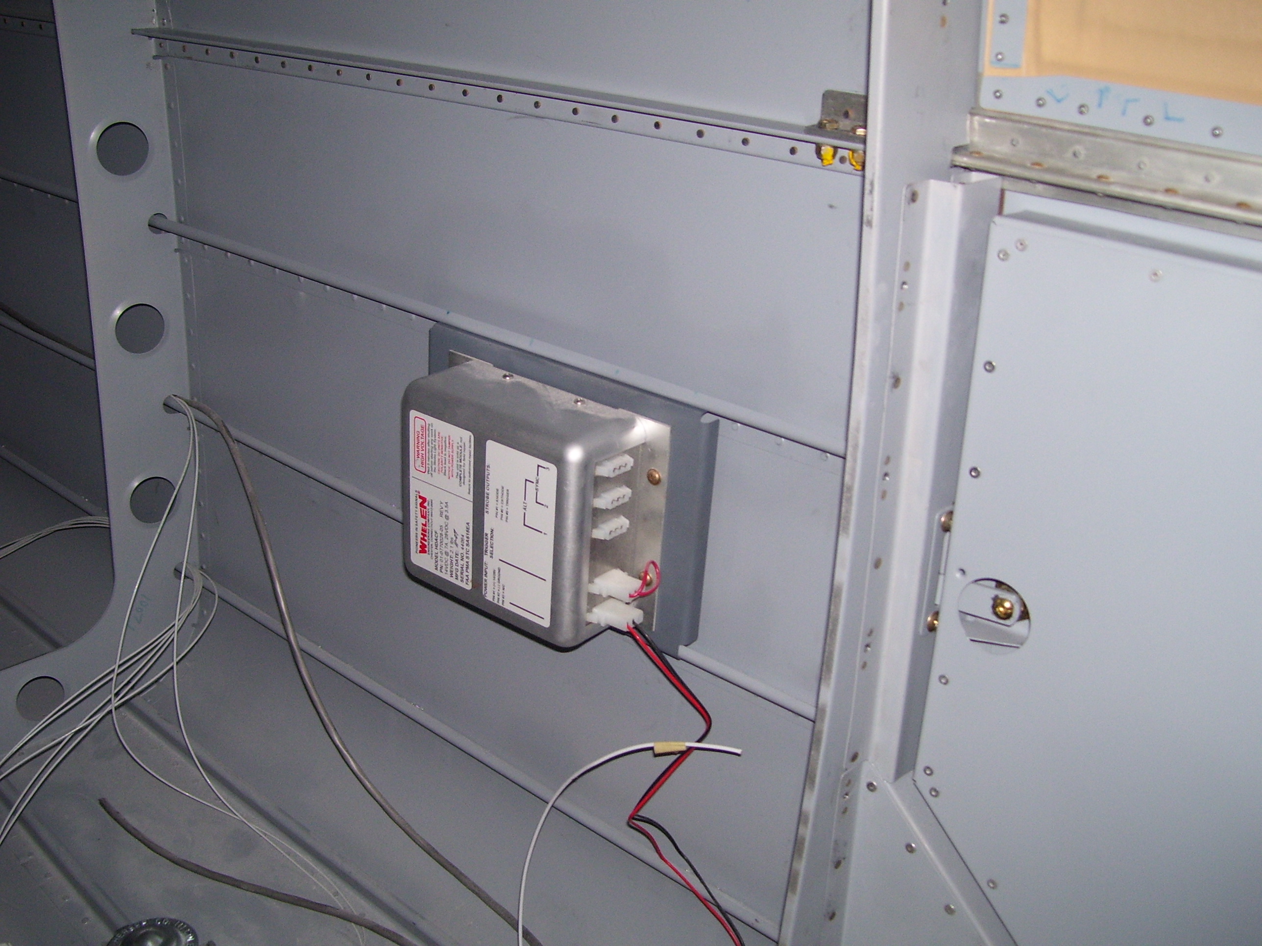

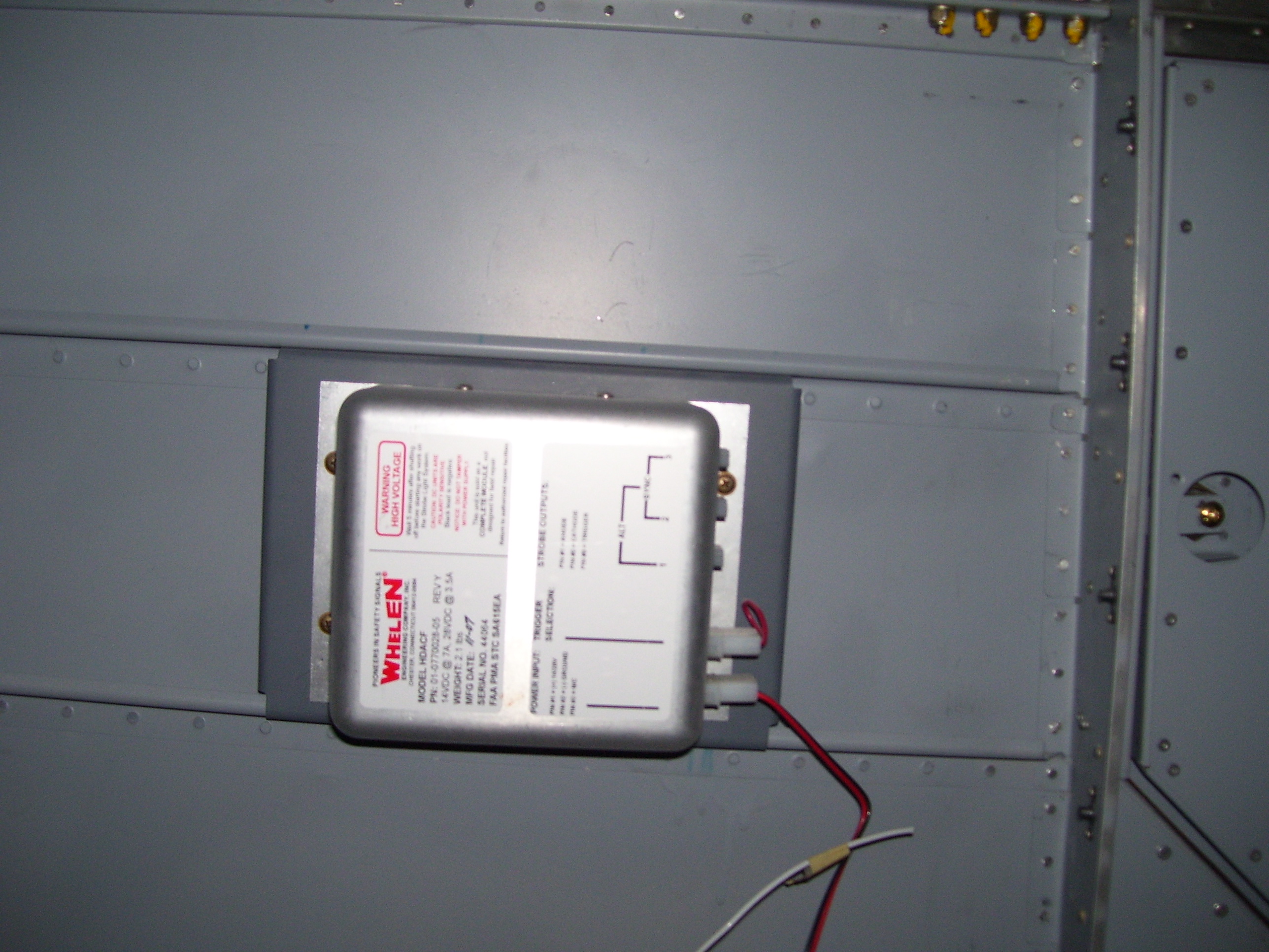

Does anyone have any installed or even not installed
photos of Van's sidewall mount for the tailcone where
you can mount the strobe supply to the wall?
Tim Olson - RV-10 N104CD

Message 5
| Subject: | Re: Photos of Van's Strobe sidewall mount? |
photos attached.
Bob Turner
RV-10 QB
http://forums.matronics.com/viewtopic.php?p=243908#243908
http://forums.matronics.com//files/100_0626_400.jpg
http://forums.matronics.com//files/100_0627_179.jpg

Message 7
Thanks Jesse. From you and another I've kind of answered my
question. That piece must fit between the stringers in
a taper so that it fits perfectly. But if I choose to mount
it lower to the floor, it may not do what I need, so I may
as well fashion my own.
Jesse Saint wrote:
> Jesse Saint
> Saint Aviation, Inc.
> jesse@saintaviation.com
> Cell: 352-427-0285
> Fax: 815-377-3694
>> do not archive
Message 8
Here are some.
Dave Leikam
RV-10 #40496
