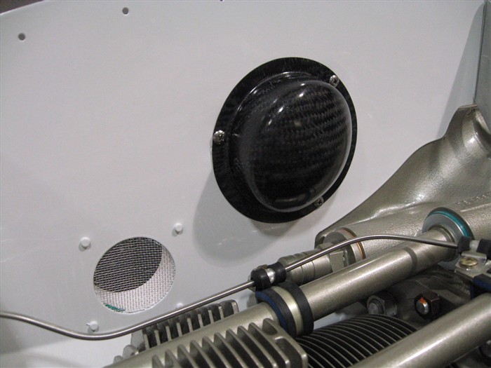

    Subject: Baffling - How did you guys go about the engine mount gap?
    From: "Michael Wellenzohn" <rv-10@wellenzohn.net>
    Hi I was wondering if you sealed the gap between engine mounts and baffling with RTV. Is there another way since the gap seams quite big. Michael -------- RV-10 builder (avionics, wiring) #511 Read this topic online here: http://forums.matronics.com/viewtopic.php?p=248196#248196 Attachments: http://forums.matronics.com//files/picture_012_214.jpg

    From: Tim Olson <Tim@MyRV10.com>
    Subject: Re: Baffling - How did you guys go about the engine mount
    gap? I've seen some rivet-on domes that you can use to cover them too. I used RTV though. Tim Olson - RV-10 N104CD Michael Wellenzohn wrote: > <rv-10@wellenzohn.net> > > Hi I was wondering if you sealed the gap between engine mounts and > baffling with RTV. Is there another way since the gap seams quite > big. > > Michael > > -------- RV-10 builder (avionics, wiring) #511 > > > > > Read this topic online here: > > http://forums.matronics.com/viewtopic.php?p=248196#248196 > > > > > Attachments: > > http://forums.matronics.com//files/picture_012_214.jpg > > > > > > >

    From: "Rene Felker" <rene@felker.com>
    That is what I did. Held up so far.....~90 hours. Rene' Felker RV-10 N423CF Flying 801-721-6080 -----Original Message----- From: owner-rv10-list-server@matronics.com [mailto:owner-rv10-list-server@matronics.com] On Behalf Of Michael Wellenzohn Sent: Monday, June 15, 2009 7:33 AM Subject: RV10-List: Baffling - How did you guys go about the engine mount gap? Hi I was wondering if you sealed the gap between engine mounts and baffling with RTV. Is there another way since the gap seams quite big. Michael -------- RV-10 builder (avionics, wiring) #511 Read this topic online here: http://forums.matronics.com/viewtopic.php?p=248196#248196 Attachments: http://forums.matronics.com//files/picture_012_214.jpg

    From: "richard sipp" <rsipp@earthlink.net>
    Subject: Re: Baffling - How did you guys go about the engine mount gap?
    I cut some pieces of baffle material into small patch circles to cover that area and pop riveted them on. Dick Sipp N110DV 40065 ----- Original Message ----- From: "Michael Wellenzohn" <rv-10@wellenzohn.net> Sent: Monday, June 15, 2009 9:32 AM Subject: RV10-List: Baffling - How did you guys go about the engine mount gap? > <rv-10@wellenzohn.net> > > Hi > I was wondering if you sealed the gap between engine mounts and baffling > with RTV. Is there another way since the gap seams quite big. > > Michael > > -------- > RV-10 builder (avionics, wiring) > #511 > > > Read this topic online here: > > http://forums.matronics.com/viewtopic.php?p=248196#248196 > > > Attachments: > > http://forums.matronics.com//files/picture_012_214.jpg > > >
