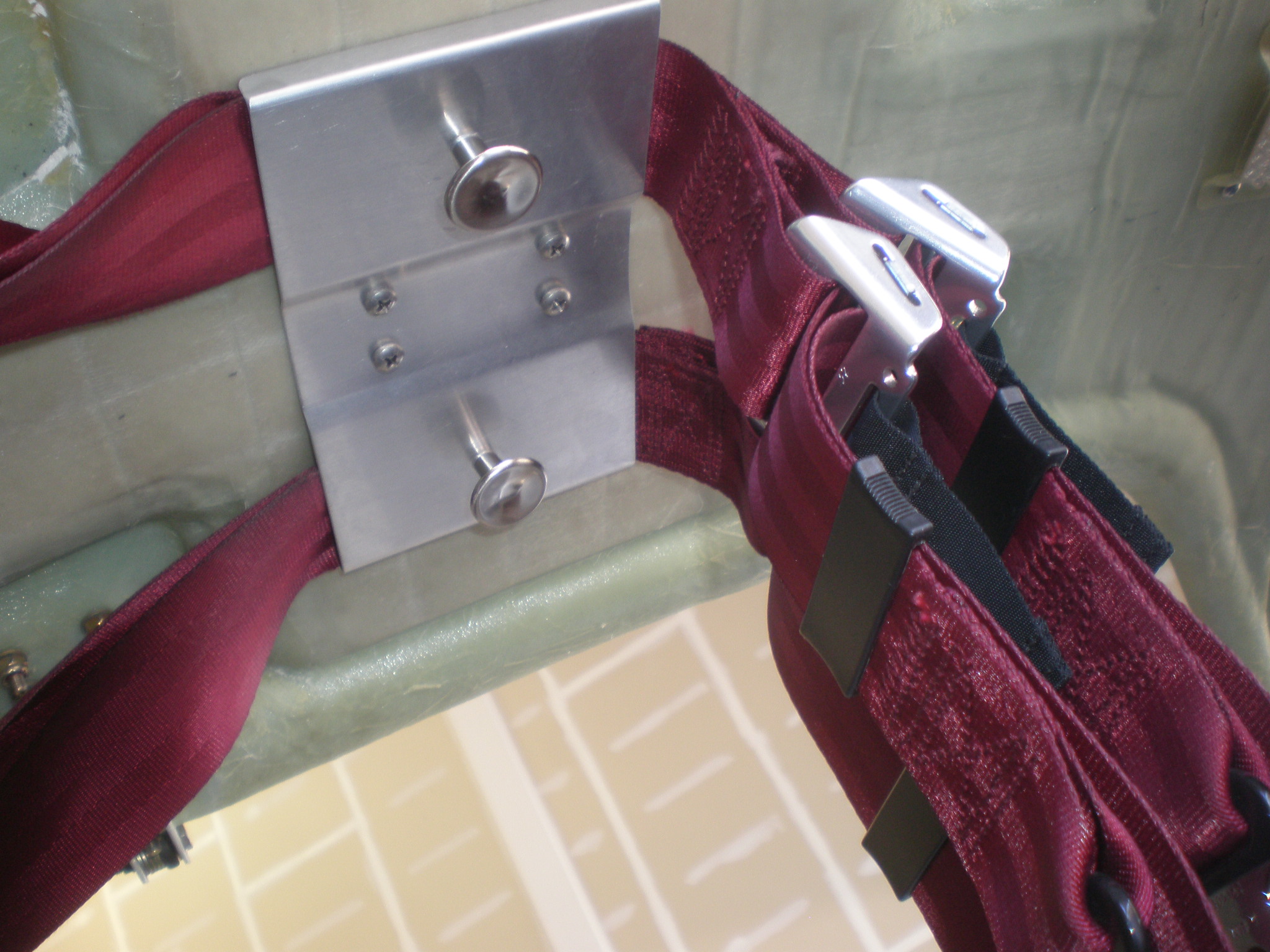

    Dave McNeil made a very cool seat belt holder from one piece of aluminum. It is fairly heavy guage aluminum. The idea of the handles is that you pull it away from the cabin top (1/4") to to release the tension that holds the "keeper" edges on the cabin top. That releases the belt. You slide it out and use it. Reverse the process upon landing. Very simple and elegant - all in one piece. Works great - looks great. I would go for a more rounded knob or lower profile, but the setup works great. -------- OSH '09 or Bust (busted) be there someday Q/B Kit - FWF end game Read this topic online here: http://forums.matronics.com/viewtopic.php?p=252753#252753 Attachments: http://forums.matronics.com//files/p7102376_660.jpg
