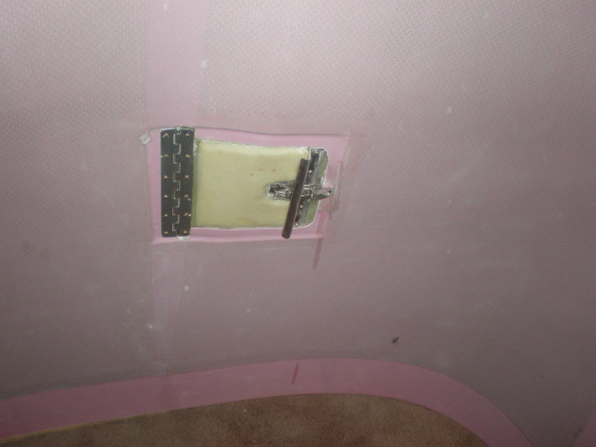

    You might want to consider putting a couple of metal strips where the cam l ock locks on the cowling due to the fact it will vibrate and wear away the composite over time.. Just a thought. Patrick Thyssen flying when electrons let me. --- On Sun, 8/16/09, jayb <jaybrinkmeyer@yahoo.com> wrote: From: jayb <jaybrinkmeyer@yahoo.com> Subject: RV10-List: Re: Oil door hidden hinge Bill, I cut a bit too much off on the inboard side also. It was pretty easy to ju st glass what was needed back on... Not a big deal. I left a lip all the wa y around. The door turned out nice. Be sure to reinforce the latch side cow l lip as there's not a lot of grip area. http://www.brinkmeyers.net/Photos/Aircraft/Engine/images/imag0095.jpg Jay MauleDriver(at)nc.rr.com wrote: > Thanks for the pics.- Yes, I thought that's what I would be doing but > I've already cut too big a hole and am planning a slightly larger door > and door opening.- Note to self; cut a small hole then enlarge as more > is learned. > > Nice site and pics.- Thanks! > > vankris wrote: > > >- > > > >- YOU shouldn't need to get into the honeycomb areas of the top cowl t o attach a hidden hinge here is a link to some pictures I hope will help yo u understand the process. http://ivankristensen.phanfare.com/2292606_426812 6#imageID=77306227 > >- This hidden hinge and the door latches are from Non Stop Aviation > > > >- Regards, > > > >- Ivan Kristensen > > > >- #40838 > > > >- FF and wiring > > > > > > > > > >- Read this topic online here: > > > >- http://forums.matronics.com/viewtopic.php?p 57821#257821 > > > > > > > > > > > > > > > > > > > > > > > > > >- - > > > > > Read this topic online here: http://forums.matronics.com/viewtopic.php?p=258131#258131 le, List Admin.

    Added some extra glass and a Z-bar stiffener and it seems to work well. Should have taken the time for the 100% hidden door, but at least it is flush and do not have the do-hickers sticking up. -------- OSH '09 or Bust (busted) be there someday Q/B Kit - end game Read this topic online here: http://forums.matronics.com/viewtopic.php?p=258152#258152 Attachments: http://forums.matronics.com//files/pc250015_810.jpg
