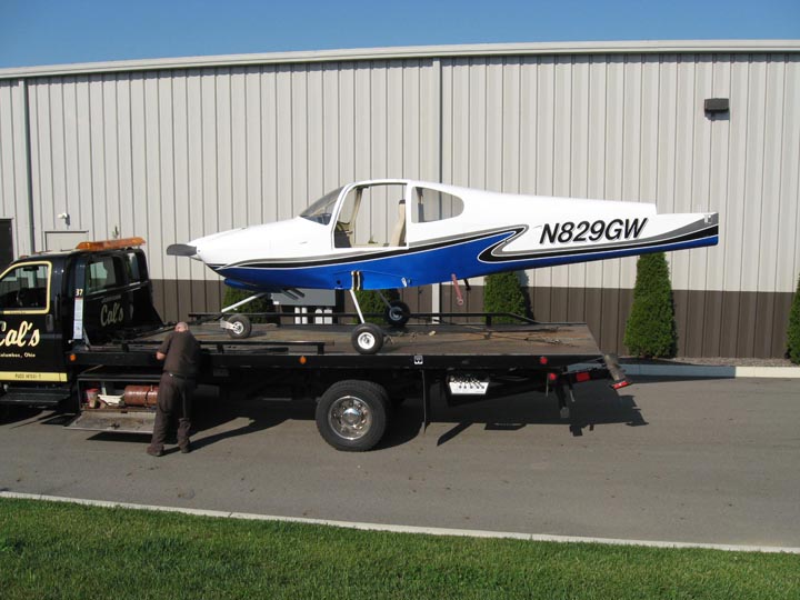

I finally got the plane moved to the airport. All went well and had plenty of great
help. Thanks to all who helped. Bob Leffler, Brad Leffler, Jim Baldwin, Jack
Ferernce, Al Moyer, Pat Ferguson, Matt Finley and Cals towing. When I called
to get prices on roll backs Cals Towing thought I was joking when I said I
need to have an airplane towed.
The end is getting near
Below is a link to more photos
Geoff
http://www.phanfare.com/album/#vw=album&ac=default&aid=3161550&sid=-1
Geoff Combs
RV-10 QB N829GW
Finishing
