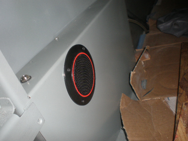

I got an inexpensive one at Fry's Electronics in Calif. - There, you can also get
a nice durable and inexpensive grill to cover the speaker.
There is a specific OHM requirement which is probably in the manual for the audio
panel. I cut a hole in the side panel at hip level in the right side of the
back seat. Seems to work fine, but with all the excellent headsets out there
- not sure it is really needed.

Not required. Just another thing to break. Put jacks at all four seats and
an aux jack on the panel.

I went to Walmart and bought a 3.5" speaker (Automotive / aviation)
and then radio shack for a plastic enclosure. Drilled a series of
holes in the enclosure and mounted it on aluminum angle under the panel
facing down at the floor. It's nice to be able to get ATIS before
engine start and not have to put on the head sets.

I mounted a 11-01569 from ACS in the upper section of the rear bulkhead.
Works great.
We put a doubler to beef up the cut in the corrugation, then the interior
cloth went right over the speaker so it's invisible.
It's about 2 feet fwd of the AFS magnetometer, but it doesn't seem to affect
it.
