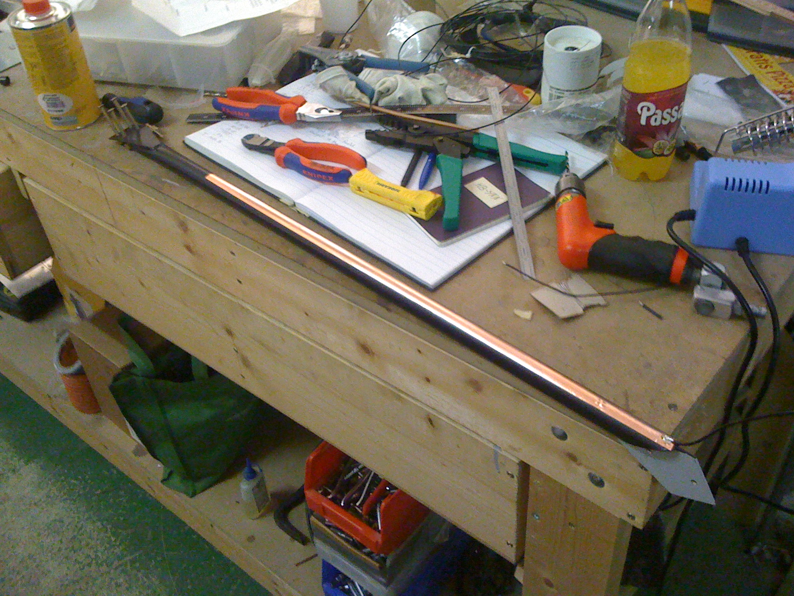

      The antenna should be 1/2 wavelength long.
      So, at 122.7 MHz, and with a speed of light at 3 x 10**8 m/sec, 1/2 of the wavelength
      is 1.22m or about 48inches.

      --- On Sun, 11/1/09, Ralph E. Capen <recapen@earthlink.net> wrote:
      > From: Ralph E. Capen <recapen@earthlink.net>
      > Subject: Re: RV10-List: First successful test of windscreen antenna
      > To: rv10-list@matronics.com
      > Date: Sunday, November 1, 2009, 9:30 PM
      > "Ralph E. Capen" <recapen@earthlink.net>
      > Help me with this please - I had one similar - on the
      > windscreen. Had it
      > tested by a bunch of HAM radio guys - they said it was too
      > short causing the
      > SWR to be bad. I had made it longer in hopes of
      > cutting it doen during
      > testing. It seemed to receive OK but couldn't
      > get anyone to hear me.....
      > How long is yours?
      > Have you tried it in flight?
      > What led you to taping it to the center post?
      > Is it insulated from the center post only by the paint?
      > Thanks,
      > Ralph Capen

      > > I just wanted to share my first positive experience
      > with the windscreen
      > > antenna taped to the center bar. I tested it by
      > holding the center bar at
      > > the right angle and attached my handheld radio to it.
      > I had no problems
      > > listening to Zurich tower although being inside a
      > concrete building.
      > > I glued the strip to the bar and covered it with black
      > tape (see attached
      > > photos)
      > > Cheers

      Most aircraft antennas start with 1/4 wavelength, not 1/2. So 24" is
      more likely to fit the space available.

      I was advised by Aerotronics in Billings Mt and at least one other avionics shop
      to just use a regular external antenna (which I did) for the COM. I was able
      to buy a used Cessna Commant antenna at OSH two years ago for about $30-$35.
      It works flawlessly. I did however use the same installation as Michael for the
      NAV antenna. As I recall it is 24 or 25 inches long. I bought the Van's product
      which is essentially a piece of copper foil glued to the headliner just behind
      the windshield. Connect it with a piece of coax cable run thru the steel
      cabin support strut I tested it's reception yesterday over the Fallon, NV  - Hazen
      VOR. I got good reception on all points of the compass. I was worried about
      the reception driving away from the VOR when the tail cone blankets the signal,
      but it worked fine.

      Michael Wellenzohn wrote:
      <rv-10@wellenzohn.net>
      > I just wanted to share my first positive experience with the
      windscreen antenna taped to the center bar. I tested it by holding the
      center bar at the right angle and attached my handheld radio to it. I
      had no problems listening to Zurich tower although being inside a
      concrete building.
      > I glued the strip to the bar and covered it with black tape (see
      attached photos)
      > Cheers
      > Michael
      > RV-10 builder (avionics, wiring)
      > #511
      > http://forums.matronics.com/viewtopic.php?p=270494#270494
      > http://forums.matronics.com//files/img_0614_124.jpg
      > http://forums.matronics.com//files/img_0612_984.jpg
      > http://forums.matronics.com//files/img_0611_181.jpg

      Use a half wavelength if you cut the wire in the middle, and feed each side with
      the coax (center to one side, braid to the other).
      Use a quarter wave length if you mount the feed end over a "ground plane" (a large
      conducting surface - maybe the glare shield is large enough). Attache the
      center conductor to the wire, the braid to the ground plane.
      Either of these gives a reasonable match to 50 ohm coax. But nearby metal may change
      the match by quite a bit, so don't be surprised if taping to the cabin support
      bar doesn't match all that great. Or maybe it will, all depends on the
      details. The fact that the cabin support bar is not perpendicular to the glare
      shield will change things, too.
      Modern receivers are very sensitive and will work with lousy antennas. The real
      test is if the tower can hear you when you transmit (especially with a low powered
      hand held). I can receive quite well on my handheld inside the cabin of
      a 182 with just the little rubber duckie antenna; but only transmit about 3 miles
      with this arrangement.
      Bob Turner
      RV-10 QB
      http://forums.matronics.com/viewtopic.php?p=270621#270621

Message 12
| Subject:  | Re: First successful test of windscreen antenna |
      My antenna strip is about 23 inches long but plus the cable its more like 24
      reception is good but I didn't try to transmit yet.
      The center bar is powder coated in flat black on top of the original gray.
      Mike
      #511
      http://forums.matronics.com/viewtopic.php?p=270632#270632
      windscreen antenna taped to the center bar. I tested it by holding the center bar
      at the right angle and attached my handheld radio to it. I had no problems
      listening to Zurich tower although being inside a concrete building.
      attached photos)
      > Cheers
      > Michael
      > #511

Message 16
      Because the center post is attached to the airframe, it is grounded.  Having your
      antenna tightly attached to a grounded piece will probably de-tune it significantly,
      or at the least cause an odd radiation pattern on transmit.
        I expect you will not find this antenna to work at all well.
        It is recommended that you install the foil strip type on the inside of the fiberglass
      roof, where it is away from the metal of the airframe.  Comm antennas
      need to be vertically polarized, so the best location is on the door post immediately
      behind the door.  I have such a foil antenna for my handheld installed
      there, and it works well.  (But for the main Comm, I rely on an external Comant
      on the belly, cause I know it will work well.)
      Phil in IL, finishing at rotary engine install
      http://forums.matronics.com/viewtopic.php?p=270659#270659
      > Having your antenna tightly attached to a grounded piece will
      > probably de-tune it significantly, or at the least cause an odd
      > radiation pattern on transmit. I expect you will not find this
      > of the fiberglass roof, where it is away from the metal of the
      > airframe.  Comm antennas need to be vertically polarized, so the best
      > location is on the door post immediately behind the door.
      Or in front of the door.  I'm going to try that place first.
      Linn
