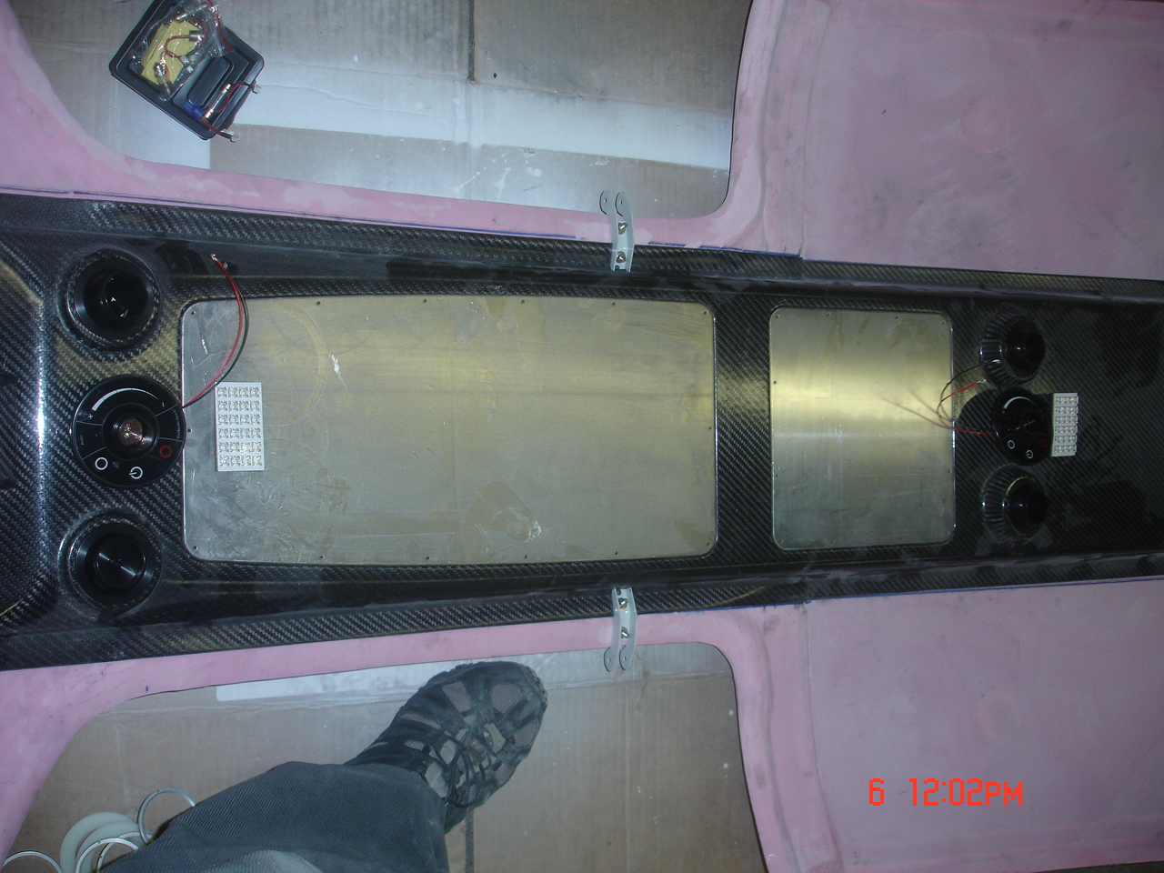

    Time: 10:58:47 AM PST US
    Subject: Overhead console configuration
    From: "Strasnuts" <sean@braunandco.com>
    I need some pro-builders, that's all of you on the list, to help me with my lights on the overhead. Pilots that have flown the 10 or pilots that have flown a lot of other planes I need your advice. That includes you Tim and Robin. I want all feedback I won't get my feelers hurt. I don't want to punch unnecessary holes in my overhead console. I have two configurations below but not limited to these. Also, I will make some bezels for the LED's. -------- Cust. #40936 RV-10 SB Fuselage N801VR reserved Read this topic online here: http://forums.matronics.com/viewtopic.php?p=280393#280393 Attachments: http://forums.matronics.com//files/dsc05528_753.jpg http://forums.matronics.com//files/dsc05527_210.jpg

    Time: 12:26:22 PM PST US
    From: "Geoff Combs" <g.combs@aerosportmodeling.com>
    Sean here is a picture of what I did. So far I really like the setup. Each passenger has there own LED reading light eyeball from Stein. Small but works good. Those have there own on-off switch next to them. I then have the small silver dome lights in the cockpit area, passenger area and then 2 in the baggage area as my dome lights. Last I have the Blue LED adjustable lights that I can shine on the panel or turn down to the pilot or copilot. Although I do not have a lot of time in the airplane this seems to work well. I like the idea of putting as many of the lights in the removable panels so if for some reason a really cool light comes out that you have to have you do not have hole to fill in the overhead just replace the panel insert or fill it and repaint. The only problem I have is I cannot get my head sets on the head set holders in the front as planned. The lights I placed to close in. I had them mounted before I decided to put the head Set hangar in. All you need to do is move them out as far as possible. Hope this helps Geoff Geoff Combs President Aerosport Modeling & Design 8090 Howe Industrial Parkway Canal Winchester, Ohio 43110 614-834-5227p 614-834-5230f www.aerosportmodeling.com -----Original Message----- From: owner-rv10-list-server@matronics.com [mailto:owner-rv10-list-server@matronics.com] On Behalf Of Bob Leffler Sent: Wednesday, January 06, 2010 3:01 PM Subject: RE: RV10-List: Overhead console configuration Sean, Are those your only lighting on the overhead? The reason I ask, is that I really like what Geoff did in his overhead. He has an eyeball type of light used for map/task lighting for each passenger. He has two of Stein's cockpit lights (B-12) mounted on the forward portion of the overhead to wash the instrument panel, and one the dome lights that Van's sells in the front and back seats, and two in the baggage area for maintenance/cleaning. I think this strategy of three different types of lighting is pretty effective. I'm sure you can talk Geoff into sharing a photo of his installation. Ironically, he doesn't have one of his own overheads. That project didn't start until his was almost ready to fly. bob -----Original Message----- From: owner-rv10-list-server@matronics.com [mailto:owner-rv10-list-server@matronics.com] On Behalf Of Strasnuts Sent: Wednesday, January 06, 2010 1:58 PM Subject: RV10-List: Overhead console configuration I need some pro-builders, that's all of you on the list, to help me with my lights on the overhead. Pilots that have flown the 10 or pilots that have flown a lot of other planes I need your advice. That includes you Tim and Robin. I want all feedback I won't get my feelers hurt. I don't want to punch unnecessary holes in my overhead console. I have two configurations below but not limited to these. Also, I will make some bezels for the LED's. -------- Cust. #40936 RV-10 SB Fuselage N801VR reserved Read this topic online here: http://forums.matronics.com/viewtopic.php?p=280393#280393 Attachments: http://forums.matronics.com//files/dsc05528_753.jpg http://forums.matronics.com//files/dsc05527_210.jpg

    Time: 12:42:40 PM PST US
    Subject: Re: Overhead console configuration
    That's nice Geoff, I like the switches for the little eyeballs. I want to make my eyebeams work but don't know where to put them. I'm re-installing the canopy right now so I can sit inside and see if the eyebeams can move far enough forward to the panel. I think I will add the eyeballs you have with the switches for each passenger. -------- Cust. #40936 RV-10 SB Fuselage N801VR reserved Read this topic online here: http://forums.matronics.com/viewtopic.php?p=280417#280417

    Probably more cost effective just to use portable units. I did that in my SUV. I also bought a couple cheap lcd screens that can be slaved off the player. The other item to keep in mind is the conversion from dvd to blu-ray. I'm already a having issues at home. We only buy blue-ray, but only have one blue ray player at the moment. For these reasons, I've decided to not installed any permanent entertainment in the RV-10. -----Original Message----- From: owner-rv10-list-server@matronics.com [mailto:owner-rv10-list-server@matronics.com] On Behalf Of Tim Olson Sent: Wednesday, January 06, 2010 3:34 PM Subject: Re: RV10-List: Re: Overhead console configuration For most people, overhead video screens won't be very comfortable to view. Especially kids. It's just plain too high up. I'd skip it and find something you can lower. Even monitors that you can hold in your hands and plug in up top would be better. Tim Olson - RV-10 N104CD do not archive Strasnuts wrote: > > Oh ya, I also might also buy this and cut out the pocket so I can fit > it inside the console and feed it video from a double din from the > panel. This way it won't stick out of the console unless it is being > used. Any other ideas on video screens? I heard some people say > they are in the way of the rear passengers > > http://www.crutchfield.com/p_077RM890W/Valor-RM-890W.html?tp=77 > > -------- Cust. #40936 RV-10 SB Fuselage N801VR reserved > > > > > Read this topic online here: > > http://forums.matronics.com/viewtopic.php?p=280409#280409 > > > > > > > > > >

    One other thing I forgot to mention was I used TCW's intelligent lighting system and it is awesome. My Dome lights can be dimmed as well as the front blue lights. The dimmer is the on-off switch as well. It has the wig wag. Easy to install. It also dims my switches and what ever else you might need. Geoff Geoff Combs President Aerosport Modeling & Design 8090 Howe Industrial Parkway Canal Winchester, Ohio 43110 614-834-5227p 614-834-5230f www.aerosportmodeling.com -----Original Message----- From: owner-rv10-list-server@matronics.com [mailto:owner-rv10-list-server@matronics.com] On Behalf Of Tim Olson Sent: Wednesday, January 06, 2010 3:37 PM Subject: Re: RV10-List: Re: Overhead console configuration You'll want the rear seaters to have SOMETHING other than a bright light. We won't let the kids use any bright lights in the back during flight. Red, Blue, whatever... you won't want it bright. Having those 2 Stein lights forward sounds like a good idea...then you can do whatever you want overhead. I find I can reach up and turn those forward lights to my lap if I need them....so other than the white dome, I don't have anything separate, and don't need it. I keep a 2 color (white/red) flashlight by each pilot seat too. A baggage light will be handy. I used a click-light back there too. One less pair of wires to run,and when you're unloading you don't need to leave a master on or worry about leaving a light on if you directly tie it to a battery bus. Click lights can be very handy since they're bus independent. Tim Olson - RV-10 N104CD do not archive Strasnuts wrote: > > I may send back the Aveoflash eyeballs. They are really cool how they > work but they are big and need protection tape like that on an Iphone > screen. I was wondering too if the rear passengers should have a red > light also so the pilot doesn't get blinded by the white light. I > like the input so far, I may still get two red LED lights from Stein > to put on the forward slants on the overhead. How many lights is too > many? I will have two eyebeams two big LED white lights, two red leds > from Stein's AND a baggage light. > > -------- Cust. #40936 RV-10 SB Fuselage N801VR reserved > > > > > Read this topic online here: > > http://forums.matronics.com/viewtopic.php?p=280407#280407 >

    Exactly....I've already dumped my old hard drive based players and got the kids apple ipod touches, which means all the work I did to make charging accessories for those from plane power is gone. So for things that change over time, I'd say stay portable. How many people owned portable VHS players...how'd you like to have one in your car/plane today? :) DVD's are not going to be THE thing forever...especially with Blu-Ray out. So for entertainment electronics, keeping it portable but coming up with a nice fixed distribution is maybe a good idea. This annual my plan is to permanently mount my video splitter, install a couple of rear-seat USB charging jacks, and find a way to make it so that one kid can plug in their ipod to standard composite video jacks and have it play on both portable screens. I can do it right now, but I don't have the distribution hard mounted, so it's a bag of stuff to bring along. Actually, like Scott was talking about, if Apple makes their tablet PC available soon, that might be a cool thing to use for in-flight video...just load the sucker up like a big ipod and then plug the audio in to your intercom. Tim Olson - RV-10 N104CD do not archive Bob Leffler wrote: > > Probably more cost effective just to use portable units. I did that in my > SUV. I also bought a couple cheap lcd screens that can be slaved off the > player. The other item to keep in mind is the conversion from dvd to > blu-ray. I'm already a having issues at home. We only buy blue-ray, but > only have one blue ray player at the moment. > > For these reasons, I've decided to not installed any permanent entertainment > in the RV-10. > > > -----Original Message----- > From: owner-rv10-list-server@matronics.com > [mailto:owner-rv10-list-server@matronics.com] On Behalf Of Tim Olson > Sent: Wednesday, January 06, 2010 3:34 PM > To: rv10-list@matronics.com > Subject: Re: RV10-List: Re: Overhead console configuration > > > For most people, overhead video screens won't be very comfortable > to view. Especially kids. It's just plain too high up. I'd > skip it and find something you can lower. Even monitors that > you can hold in your hands and plug in up top would be better. > > Tim Olson - RV-10 N104CD > do not archive > > > Strasnuts wrote: >> >> Oh ya, I also might also buy this and cut out the pocket so I can fit >> it inside the console and feed it video from a double din from the >> panel. This way it won't stick out of the console unless it is being >> used. Any other ideas on video screens? I heard some people say >> they are in the way of the rear passengers >> >> http://www.crutchfield.com/p_077RM890W/Valor-RM-890W.html?tp=77 >> >> -------- Cust. #40936 RV-10 SB Fuselage N801VR reserved >> >> >> >> >> Read this topic online here: >> >> http://forums.matronics.com/viewtopic.php?p=280409#280409 >> >> >> >> >> >> >> >> >> >> > > > > > > > >

    Has anyone used both red and blue lights enough to have a preference? I've flown with red but never with blue. Bill > >

    I like the idea of power usb's and the tablets. I just noticed the screens coming out that are paper thin, flexible and you can wear them on a t-shirt. I'm now convinced to not install any permenant entertainment except my garmins of course. Sent from my iPhone On Jan 6, 2010, at 14:34, Tim Olson <Tim@MyRV10.com> wrote: > > Exactly....I've already dumped my old hard drive based players > and got the kids apple ipod touches, which means all the work > I did to make charging accessories for those from plane power > is gone. So for things that change over time, I'd say stay > portable. How many people owned portable VHS players...how'd > you like to have one in your car/plane today? :) DVD's are > not going to be THE thing forever...especially with Blu-Ray > out. So for entertainment electronics, keeping it portable > but coming up with a nice fixed distribution is maybe a good > idea. This annual my plan is to permanently mount my video > splitter, install a couple of rear-seat USB charging jacks, > and find a way to make it so that one kid can plug in their > ipod to standard composite video jacks and have it play > on both portable screens. I can do it right now, but I don't > have the distribution hard mounted, so it's a bag of stuff > to bring along. > > Actually, like Scott was talking about, if Apple makes their > tablet PC available soon, that might be a cool thing to use > for in-flight video...just load the sucker up like a big > ipod and then plug the audio in to your intercom. > > > Tim Olson - RV-10 N104CD > do not archive > > > Bob Leffler wrote: >> Probably more cost effective just to use portable units. I did >> that in my >> SUV. I also bought a couple cheap lcd screens that can be slaved >> off the >> player. The other item to keep in mind is the conversion from dvd to >> blu-ray. I'm already a having issues at home. We only buy blue- >> ray, but >> only have one blue ray player at the moment. >> For these reasons, I've decided to not installed any permanent >> entertainment >> in the RV-10. >> -----Original Message----- >> From: owner-rv10-list-server@matronics.com >> [mailto:owner-rv10-list-server@matronics.com] On Behalf Of Tim Olson >> Sent: Wednesday, January 06, 2010 3:34 PM >> To: rv10-list@matronics.com >> Subject: Re: RV10-List: Re: Overhead console configuration >> For most people, overhead video screens won't be very comfortable >> to view. Especially kids. It's just plain too high up. I'd >> skip it and find something you can lower. Even monitors that >> you can hold in your hands and plug in up top would be better. >> Tim Olson - RV-10 N104CD >> do not archive >> Strasnuts wrote: >>> >>> Oh ya, I also might also buy this and cut out the pocket so I can >>> fit >>> it inside the console and feed it video from a double din from the >>> panel. This way it won't stick out of the console unless it is >>> being >>> used. Any other ideas on video screens? I heard some people say >>> they are in the way of the rear passengers >>> >>> http://www.crutchfield.com/p_077RM890W/Valor-RM-890W.html?tp=77 >>> >>> -------- Cust. #40936 RV-10 SB Fuselage N801VR reserved >>> >>> >>> >>> >>> Read this topic online here: >>> >>> http://forums.matronics.com/viewtopic.php?p=280409#280409 >>> >>> >>> >>> >>> >>> >>> >>> >>> >>> > >

    > The baggage light will have its own pair of switches. > 1) Local in the baggage compartment to help during > loading/unloading. > 2) Cockpit switch: So mom can crawl back there in flight and dig > through bags for diapers, bottles, and band-aids. :) > I spoke to a couple of flying RV-10 builders and they told me to get a portable LED light that I can just velcro and use as needed as they have used their baggage switch less than a hand full of time sin the last 2 years. Just a thought on maybe an easier solution. -------------------------------------------------- From: "Perry, Phil" <Phil.Perry@netapp.com> Sent: Wednesday, January 06, 2010 12:35 PM Subject: RE: RV10-List: Re: Overhead console configuration > > I really wanted the Aveo's but your experience has started to turn me > off. (... and save me money) > > Now I'm leaning toward Stein's lights (2x) front, (2x) rear, 1(x) > baggage. I'm planning to us a off/on-dimmer in the front for each light > and the same thing for the rear seats. That makes a total of four > off/on-dimmers for local control. > > But, I'm also planning to install a master (read "Kiddie") switch for > the rear lights. So I can shut them off up front and don't have to > worry about a kid flipping on lights unless I want them to. If I were a > kid, I'd do it just to make dad turn around and slap me... I know how I > thought. > > The baggage light will have its own pair of switches. > 1) Local in the baggage compartment to help during > loading/unloading. > 2) Cockpit switch: So mom can crawl back there in flight and dig > through bags for diapers, bottles, and band-aids. :) > > Phil > > > -----Original Message----- > From: Strasnuts [mailto:sean@braunandco.com] > Sent: Wednesday, January 06, 2010 2:07 PM > To: rv10-list@matronics.com > Subject: RV10-List: Re: Overhead console configuration > > > I may send back the Aveoflash eyeballs. They are really cool how they > work but they are big and need protection tape like that on an Iphone > screen. I was wondering too if the rear passengers should have a red > light also so the pilot doesn't get blinded by the white light. I like > the input so far, I may still get two red LED lights from Stein to put > on the forward slants on the overhead. How many lights is too many? I > will have two eyebeams two big LED white lights, two red leds from > Stein's AND a baggage light. > > -------- > Cust. #40936 > RV-10 SB Fuselage > N801VR reserved > > > Read this topic online here: > > http://forums.matronics.com/viewtopic.php?p=280407#280407 > > >

    I went with the portable LED light velcroed in the baggage area and it works great. David Maib 40559 Flying On Jan 6, 2010, at 7:49 PM, Pascal wrote: > The baggage light will have its own pair of switches. > 1) Local in the baggage compartment to help during > loading/unloading. > 2) Cockpit switch: So mom can crawl back there in flight and dig > through bags for diapers, bottles, and band-aids. :) > I spoke to a couple of flying RV-10 builders and they told me to get a portable LED light that I can just velcro and use as needed as they have used their baggage switch less than a hand full of time sin the last 2 years. Just a thought on maybe an easier solution. -------------------------------------------------- From: "Perry, Phil" <Phil.Perry@netapp.com> Sent: Wednesday, January 06, 2010 12:35 PM Subject: RE: RV10-List: Re: Overhead console configuration > > I really wanted the Aveo's but your experience has started to turn me > off. (... and save me money) > > Now I'm leaning toward Stein's lights (2x) front, (2x) rear, 1(x) > baggage. I'm planning to us a off/on-dimmer in the front for each > light > and the same thing for the rear seats. That makes a total of four > off/on-dimmers for local control. > > But, I'm also planning to install a master (read "Kiddie") switch for > the rear lights. So I can shut them off up front and don't have to > worry about a kid flipping on lights unless I want them to. If I > were a > kid, I'd do it just to make dad turn around and slap me... I know > how I > thought. > > The baggage light will have its own pair of switches. > 1) Local in the baggage compartment to help during > loading/unloading. > 2) Cockpit switch: So mom can crawl back there in flight and dig > through bags for diapers, bottles, and band-aids. :) > > Phil > > > -----Original Message----- > From: Strasnuts [mailto:sean@braunandco.com] > Sent: Wednesday, January 06, 2010 2:07 PM > To: rv10-list@matronics.com > Subject: RV10-List: Re: Overhead console configuration > > > I may send back the Aveoflash eyeballs. They are really cool how they > work but they are big and need protection tape like that on an Iphone > screen. I was wondering too if the rear passengers should have a red > light also so the pilot doesn't get blinded by the white light. I > like > the input so far, I may still get two red LED lights from Stein to put > on the forward slants on the overhead. How many lights is too > many? I > will have two eyebeams two big LED white lights, two red leds from > Stein's AND a baggage light. > > -------- > Cust. #40936 > RV-10 SB Fuselage > N801VR reserved > > > Read this topic online here: > > http://forums.matronics.com/viewtopic.php?p=280407#280407 > >

    I'm going to answer my own question regarding red and blue lights with this from the archives: *From: * */"jim berry" <jimberry(at)qwest.net>/* *Date: * */Mar 24, 2007/* *Tim Great info on your cockpit lighting and good timing as I am making those decisions now for my panel. I recently posed the question of red versus blue lighting to a friend who is an ophthalmologist, long time pilot with 6 planes ( C421, C185 on floats, C150, Pitts, Fuqua jet, Eclipse vlj on order. Must be tough staying current in all his toys.) Without getting into a discussion of photoreceptors and how the eye works, his response is "if you are primarily interested in seeing outside the cockpit go with red lights. If you are more concerned about reading maps, charts, etc in the cockpit go with blue lighting." He uses only blue. Jim Berry 40482 Finishing * Bill Mauledriver Watson wrote: > <MauleDriver@nc.rr.com> > > Has anyone used both red and blue lights enough to have a preference? > I've flown with red but never with blue. > > Bill >> >> > >

    But that doesn't really provide the answer to ehat YOU should do...because you may feel either way. ;). I myself am primarily concerned with seeing outside...as I have to do that to land. So that conflicts with his having blue, in my case. I just need to make sure my red is adjusted so I can see switches. Blue wouldn't be bad, I'm sure, but my biggest goal is maintaining outside vision. Tim On Jan 6, 2010, at 8:38 PM, Bill Mauledriver Watson <MauleDriver@nc.rr.com > wrote: > I'm going to answer my own question regarding red and blue lights > with this from the archives: > > From: "jim berry" <jimberry(at)qwest.net> > Date: Mar 24, 2007 > Tim Great info on your cockpit lighting and good timing as I am > making those decisions now for my panel. I recently posed the > question of red versus blue lighting to a friend who is an > ophthalmologist, long time pilot with 6 planes ( C421, C185 on > floats, C150, Pitts, Fuqua jet, Eclipse vlj on order. Must be tough > staying current in all his toys.) Without getting into a discussion > of photoreceptors and how the eye works, his response is "if you are > primarily interested in seeing outside the cockpit go with red > lights. If you are more concerned about reading maps, charts, etc in > the cockpit go with blue lighting." He uses only blue. Jim Berry > 40482 Finishing > > > Bill Mauledriver Watson wrote: >> >> > >> >> Has anyone used both red and blue lights enough to have a >> preference? I've flown with red but never with blue. >> >> Bill >>> >>> >> >> >> >> >> >> >> >> >> >> >> >> >> >> >> >> >> >> >> >> >> >> >> >> >> >> >> >> >> > >

    Actually it did - I'm going red for the same reasons you stated. Outside vision is the goal. My switches and screens are lit. Not being able to see magenta stuff on the chart is tolerable though disconcerting at times. Description Unit price Qty Amount LED Map / Cockpit Light, Red 12VDC Item# MAPLIGHT-R-12 $44.50 USD 2 $89.00 USD Hi Stein! Tim Olson wrote: > But that doesn't really provide the answer to ehat YOU should > do...because you may feel either way. ;). I myself am primarily > concerned with seeing outside...as I have to do that to land. So that > conflicts with his having blue, in my case. I just need to make sure > my red is adjusted so I can see switches. Blue wouldn't be bad, I'm > sure, but my biggest goal is maintaining outside vision. > Tim > > > On Jan 6, 2010, at 8:38 PM, Bill Mauledriver Watson > <MauleDriver@nc.rr.com <mailto:MauleDriver@nc.rr.com>> wrote: > >> I'm going to answer my own question regarding red and blue lights >> with this from the archives: >> >> *From: * */"jim berry" <jimberry(at)qwest.net <http://qwest.net>>/* >> >> *Date: * */Mar 24, 2007/* >> >> *Tim Great info on your cockpit lighting and good timing as I am >> making those decisions now for my panel. I recently posed the >> question of red versus blue lighting to a friend who is an >> ophthalmologist, long time pilot with 6 planes ( C421, C185 on >> floats, C150, Pitts, Fuqua jet, Eclipse vlj on order. Must be >> tough staying current in all his toys.) Without getting into a >> discussion of photoreceptors and how the eye works, his response >> is "if you are primarily interested in seeing outside the cockpit >> go with red lights. If you are more concerned about reading maps, >> charts, etc in the cockpit go with blue lighting." He uses only >> blue. Jim Berry 40482 Finishing * >> >> >> >> Bill Mauledriver Watson wrote: >>> <MauleDriver@nc.rr.com <mailto:MauleDriver@nc.rr.com>> >>> >>> Has anyone used both red and blue lights enough to have a >>> preference? I've flown with red but never with blue. >>> >>> Bill >>>> >>>> >>> >>> >>> >>> >>> >>> >>> >>> >>> >>> >>> >>> >>> >>> >>> >>> >>> >>> >>> >>> >>> >>> >>> >>> >>> >>> >>> >>> >>> >> >> * >> >> >> * > * > > > *
