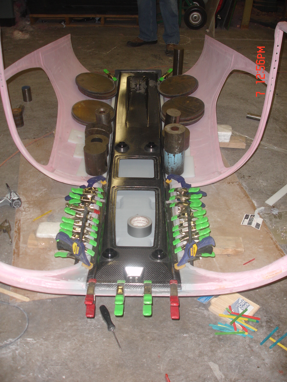

Gluing on the overhead console. I went overboard with the weights even though
the console fits good on the canopy.
