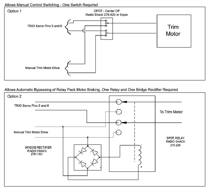

    Lyle, There are two ways to wire in the AP auto-trim system from TT. First way is as you describe - when the AP is enabled the auto-trim system takes over and manual trim is disabled. Second way has a switch to disable autotrim completely at any time and revert to manual trim. Bob Read this topic online here: http://forums.matronics.com/viewtopic.php?p=313479#313479

    Here's how Trio Avionics suggests to wire in their autotrim. The autopilot has trim all the time, except when you activate the manual trim, the power going down the trim wires, will activate a relay which removes control from the autopilot's autotrim and gives control to the manual one. This works out pretty good as long as that relay doesn't fail. I have yet to figure out what are the failure modes of the Omron relay. I was thinking of hooking up a relay to a microcontroller and let it switch on and off a gazillion times until it fails. The cool feature i like about this is that when the autopilot is not engaged, the knob on the autopilot can be used to run the trim, which provides for a nice backup to the manual trim system. See attached image for wiring (Option 2) Lenny Read this topic online here: http://forums.matronics.com/viewtopic.php?p=313511#313511

    Oops, forgot the picture. Here it is: -------- Lenny #40803 Read this topic online here: http://forums.matronics.com/viewtopic.php?p=313518#313518 Attachments: http://forums.matronics.com//files/trio_autotrim_157.jpg

    I think I will install a "pitch trim enable" push button switch just above my rocker switch on the panel. Switch will have deep bezel. Both next to throttle control. Then no worries about motor speed, stuck relays, kids or something resting on the stick. Also less weight/money/build time. -------- Wayne Gillispie, A&amp;P 5/93, PPC 10/08 Grayson, KY Bldr# 40983 Ord complete kit 8/24/09; DB Sch del 11/20/09 Emp 12/01/09-3/14/10 332 hrs Wings 3/14/10- Read this topic online here: http://forums.matronics.com/viewtopic.php?p=313527#313527
