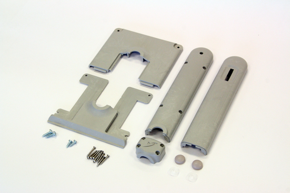

    Aerosport Products has completed and will be shipping the new Door handle covers designed for the stock Van's door handles. These handles and cover plates can be installed in minutes and dress up the not so nice looking interior door handle. The cover plate covers the gear box area. They will be available in 2 colors a Light tan and a Med Grey. These handles are made from ABS plastic and can be painted to match your interior colors. They will be available online at www.aerosportproducts.com On 2-7-11 Cost will be $95.00 per set. And $65.00 for just the door handle covers. Geoff -------- Geoff Combs RV-10 QB N829GW Flying 40033 Read this topic online here: http://forums.matronics.com/viewtopic.php?p=329349#329349 Attachments: http://forums.matronics.com//files/doorhandleparts_493.jpg http://forums.matronics.com//files/doorhandle_175.jpg

    aerosport1 wrote: > They will be available online at www.aerosportproducts.com On 2-7-11 Geoff underestimated his webmaster.... :D The RV-10 Door Handle Kits can be ordered online at: http://aerosportproducts.com/handles.htm bob -------- Bob Leffler N410BL - FWF RV-10 #40684 http://mykitlog.com/rleffler Read this topic online here: http://forums.matronics.com/viewtopic.php?p=329379#329379
