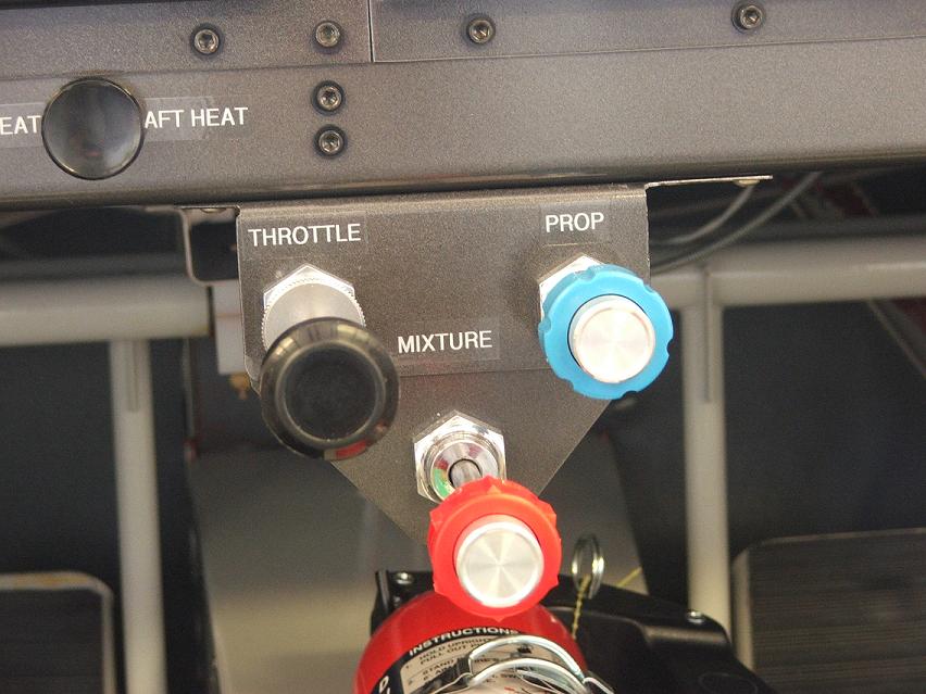

I have been meaning to send this for a while but have been too busy in phase 1
testing. This is an old problem but slightly different spin. I have the infinity
stick grips and they are known to have a problem with clearing the bottom
of the panel. The fix is to cut the control sticks as short as possible. This
gives a nominal clearance of about a half an inch between the top of the stick
grip and the bottom of the panel - the bottom strip that usually holds circuit
breakers. I was careful and mine cleared the panel.
One of the last things to install are the control cables. Yes, they are too short.
More interesting was the interference between the right stick and the mixture
control. The right stick when moved full left could be hung up on the LEFT
side of the mixture control. See the photo. This was unacceptable even though
in flight it would be tough to get it there. My control cables are stock
and in the design location.
There are several ways to fix this but the one shown in the photo utilizes the
stock cable. A slight modification to the support removed the interference.
I actually like the fact that the mixture control is now below the throttle and
prop. This minimizes inadvertently grabbing the mixture control instead of
the prop.

Well, you're right, that would not be acceptable. Are you sure the right stick
is vertical with the ailerons neutral? On mine the stick just barely touched the
RIGHT side of the mixture knob, full over to the left. I adjusted the stick
position (under the right seat) a bit, and now it doesn't touch.
BTW, I found I could hang up the stick if I moved to a certain position in a certain
way. The culprit was a bolt under the seat in the control mechanism. I installed
it per plans and it could hang up. The fix was to reverse the direction
of bolt. The head wasn't long enough to interfere with the head forward.
Bob Turner

On my plane I cut the sticks down to just barely enough to mount the
Infinity Grip. I also replaced the control cable bracket with a more narrow
one (but keep the same knob spacing). This provides just enough clearance.
Both cabin heat, alternate air and oil cooler air controls are on the bottom
panel apron.
Carl

Nice fix.
For others encountering stick/panel interference, another approach is bending the
stick in a press, i.e. increasing the curvature. Lots in the archives.
Sent from my iPad
and prop. This minimizes inadvertently grabbing the mixture control instead of
the prop.
> Dave Moore
> RV-6 flying
> RV-10 QB - flying
> http://forums.matronics.com/viewtopic.php?p=376266#376266
