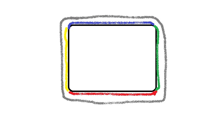

    Time: 09:05:33 AM PST US
    Subject: Re: Glassing Window Transition
    From: "tsts4" <tsts4@verizon.net>
    I've attached a crude graphic to illustrate for visual learners like me what I 'm trying to figure out. The window shape is the black rectangle, the colored lines rep individual tapes butted together at the corners and the gray is a single ring of tape cut to the window's shape in lieu of using individual pieces. Seems like based on the answers so far (and my own very limited fiberglass experience) that the individual tapes are the way to go, but I'm open to suggestions. -------- Todd Stovall aka Auburntsts on EAA, AOPA, Purple Pilots, VAF, and RVairspace 728TT RV-10 Empacone, Wings, Fuse, Finishing www.mykitlog.com/auburntsts Read this topic online here: http://forums.matronics.com/viewtopic.php?p=380842#380842 Attachments: http://forums.matronics.com//files/window_194.jpg
