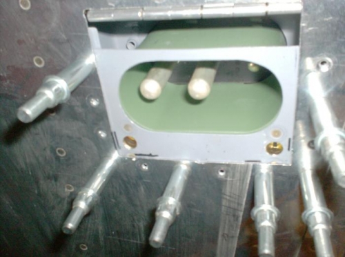

Absolutely. I put handles on both sides, right under the rear windows. The object
is to let the passenger grab it before they put their foot on the step. Exiting,
I find it useful for me backing off the wing.
If you go to the aviation department at Home Depot, or Lowes, you can find them
labeled as drawer pulls. Get the attractive 4" one.
John
#40572 Phase One complete and flying.
http://forums.matronics.com/viewtopic.php?p=394563#394563
http://forums.matronics.com//files/handle_498.jpg

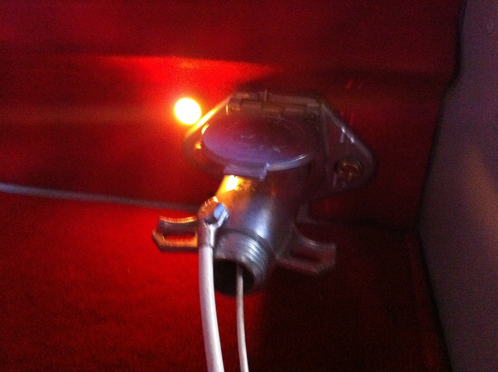

What are the current methods for ground power attachment for battery
boost and jumping without removing the rear bulkhead panels?
Photos if possible?
David Leikam
Message 10
| Subject: | Re: ground power attach |
Haven't done it yet, but I'm going to mount a Piper receptacle in the
rear bulkhead .... accessible through the baggage door.

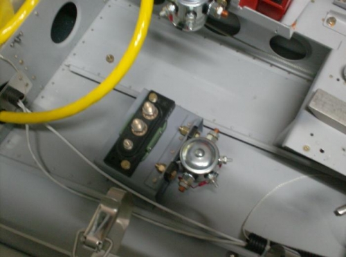

Message 12
| Subject: | ground power attach |
I have a AMP style connector with #10 wire going to battery and a lead set
that plugs into connector in photo. It also
has #10 wire leads that can be hooked to charger or cables. I use it to
charge as needed.
2 weeks ago left master on and battery was dead after 2 hours. I jumped the
airplane using my connector with
leads from a car. We let it charge with the car for about 3 minutes and then
jumped in and it started right up.
Worked great. I was worried with the wire size. It was designed for mainly
charging. Small and compact
The DB9 connector is for ADSB programming
FWIW

I also have yet to do this, but this thread got me thinking that maybe
it would be better to put the receptacle on the floor just forward of
the bulkhead so you don't have to remove a cover or worry about
disconnecting wires when it comes time to pull the bulkhead. The Piper
setup seem like a great way to go though since it has a flip cover to
protect the connections. Just a thought.

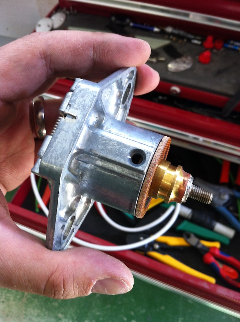

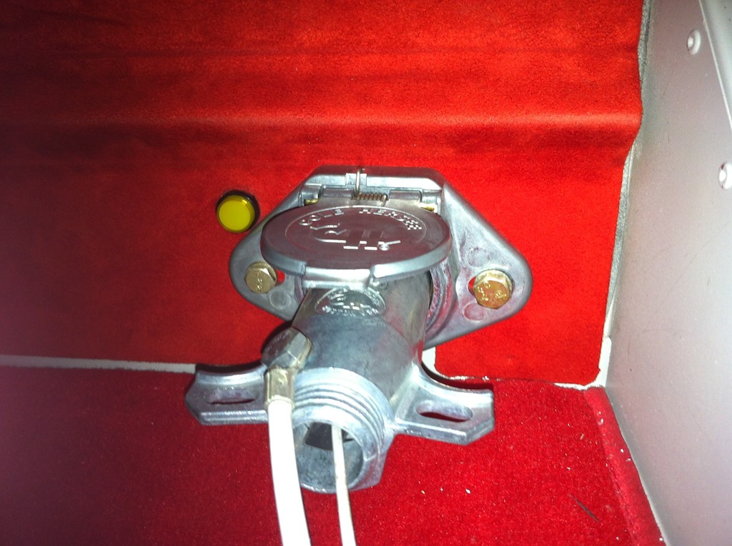

Message 14
I bought the Piper receptacle from ACS and then wired the male end with wel
ding cables that you can attach to your battery charger and or jumper cable
s to. Works very well for the minimal amount of money. If you want=2C I'll
be glad to send you a picture. Email me at: jdriggs49@msn.com

Hmmm. Lighter and less expensive than the Piper aux power (I think),
but not compatible with the standard airport cart. Carrying around your
jumper cables may make up the weight penalty. How often do you need to
reprogram the ADSB???
Linn

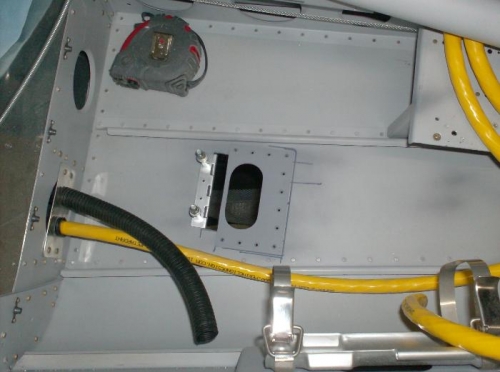

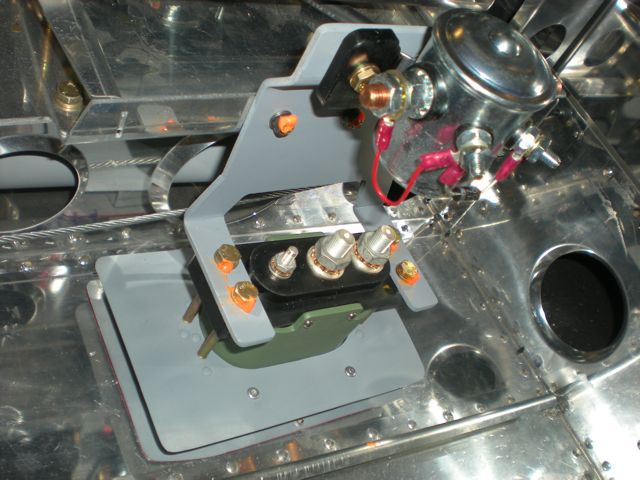

I bought the military style from Spruce and put it on the floor next to the battery
tray.
John
http://forums.matronics.com/viewtopic.php?p=394593#394593
Linn
I only have to update it if a new software release comes out. So far about
3-4 times in the last year.
Geoff Combs

Message 27
I also went the mil-type 3-prong connector mounted next to the battery with an
access panel on the bottom of the tailcone.
Todd Stovall
aka Auburntsts on EAA, AOPA, Purple Pilots, VAF, and RVairspace
RV-10 N728TT
Empacone, Wings, Fuse, Finishing
www.mykitlog.com/auburntsts
http://forums.matronics.com/viewtopic.php?p=394612#394612

Message 28
Here is my setup:
I used the setup proposed by vertical power but used a different plug.
In order to activate it i press the yellow button which lights up when active.
I can't find right now the description on how to modify the
power socket but will post it later. Basically you cut off the back part and solder
in a bolt to attach the #2 cable.
Michael
RV-10 builder (interior & finishing)
#511
http://forums.matronics.com/viewtopic.php?p=394615#394615

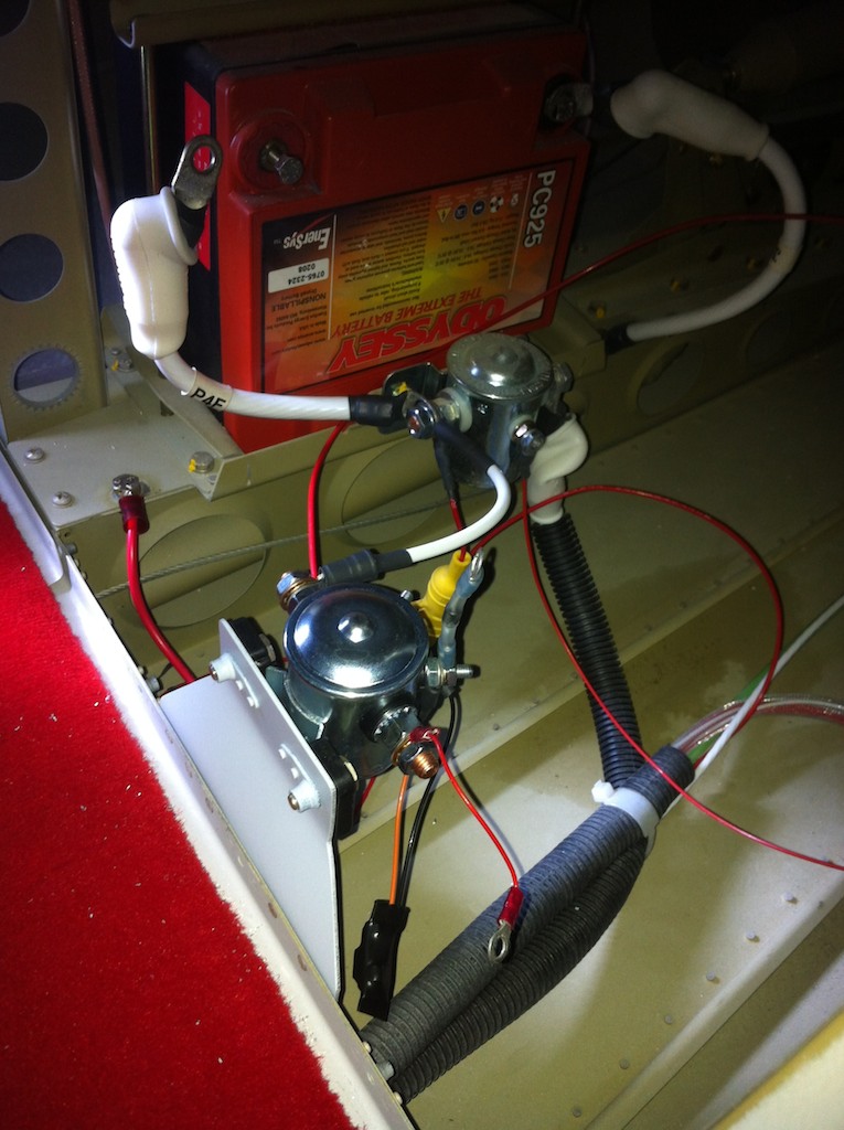

Here's mine. I used the Aero'lectric diagram for the Piper plug since I already
had the cables.
The thing I really like about it so far is that I've been able to power up systems
to test during construction without spending on a proper battery yet which
I don't plan to buy until right before first flight.
Myron Nelson
