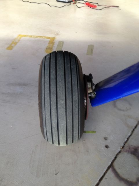

I can't resist jumping into this one. I have 106 landings on the original Van's
tires. I have only filled them once - when I built them. They still have 42 in
the mains and 40 in the nose. I don't have wheel pants (hate 'em). Here is a
photo. Notice no uneven wear.

I can believe 5 kts like Bob. A round tube has 9 times the drag of a airfoil shape.
John, you started out with 42 psi and one year later ended with 42 psi? You have
some super rubber there! Or maybe every time you fly with your tires exposed,
the 160 kt air molecules are keeping the pressure maintained.
I do love the looks and speed of my pants. Exposed tires/brakes were really nice
for rentals. On mine, my preflight consist of ensuring they are not flat and
that I have good brake pressure.

I really wouldn't be hard to get rid of the ugly exposed wheels by putting the
fairings on, but install a Camlok or similar latch right over the brakes if you
really wanted the speed, efficiency, AND ability to do a full preflight of the
wheels often. There is middle ground.
