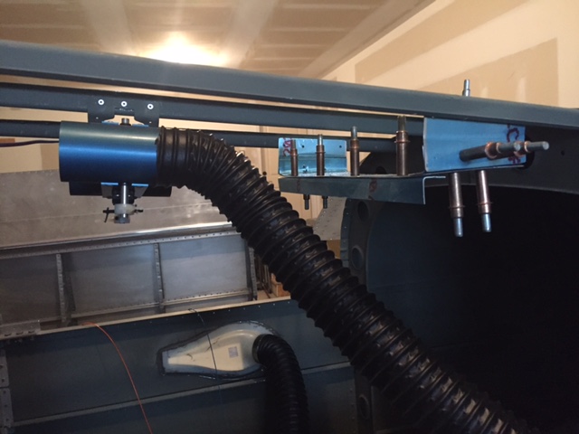

    I've about had all I can handle finding a simple and effective way to mount these Ray Allen POS-12 sensors in the airframe. No matter what I do I can't find a good way to mount them where they can travel with the flap system. I've been trying to mount them under the flap tube covers on the rear seats mounted to the rear spar area and attached to the tube. I've nearly thrown my phone clear across this hangar about 15 times and I've invented cuss words that didn't exist before I took on this (what should be) ridiculously simple task. I need some better ideas and photos. I don't want to scrap this plane because of a $20 sensor but right now I've had all I can handle. Thanks for letting me vent and for the ideas gentlemen. Phil Sent from my iPhone

    No issues here. I have the naca vent valve maybe 6 inches behind the baggage bulkhead right near the top skin, and the magnetometer on the top of the front side of the next bulkhead back. On Mon, Feb 29, 2016 at 5:54 PM, mhealydds <mhealydds@gmail.com> wrote: > > For those of you flying and have Aerosport's vent valve, is there ever an > interference with magnetometer mounted in the area? I have fabricated > bracket for my two Dynon magnetometers in most forward area of tailcone > area (see picture) and was worried about its proximity to the vent valve. > If there would be a problem would it just be when vent valve is activated > (opened or closed)? > > Thanks, > Matt > > > Read this topic online here: > > http://forums.matronics.com/viewtopic.php?p=453303#453303 > > > Attachments: > > http://forums.matronics.com//files/img_1708_205.jpg > >
