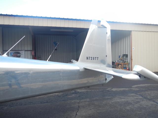

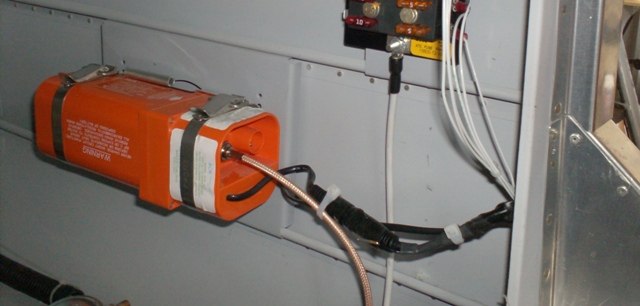

I installed my antenna on top just in front of the vertical stabilizer per
the manufacturer's plans. The ELT is mounted to the sidewall just behind t
he baggage bulkhead.
My reasoning is that nobody can predict the state of the aircraft once it's
back on the ground. It may be upside down, right side up, or any position
in between. It may be whole, or it may be torn apart upon impact. I am
of the belief that speculation on the final state is an exercise in futili

I put mine where it's supposed to be - 406 ELT on a bulkhead behind the baggage
compartment, and the antenna directly above it. Photo (hopefully) attached.
John
http://forums.matronics.com/viewtopic.php?p=470147#470147

Message 14
| Subject: | Re: ELT and ELT antenna placement |
I installed mine just like Bob Leffler did. For the ELT I used the mount Van's
sells and placed it about a foot behind the baggage bulkehad on the pilot's side.
Todd Stovall
